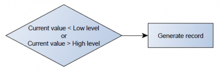

It seems that hysteresis is not suitable if you need an alert bellow 10v and above 12v.
The operand that should be used is On Exit
On Exit ”Record is generated when input value leaves a range between low and high level limits.”
Hysteresis “Record is generated when input value crosses the high limit value from below the low limit value or vice versa.“
Source: FMB130 I/O settings - Teltonika Telematics Wiki
Also take note of how Avg constant works since that also adds to the delay. If Avg Const value is 10, new value must be present for 1 second to register the change to a new value. Internal sampling is done every 40 ms, so 25 samples are taken per second. To configure 5 seconds of averaging multiply 10 by 5 yielding 50 as Avg Const value.
