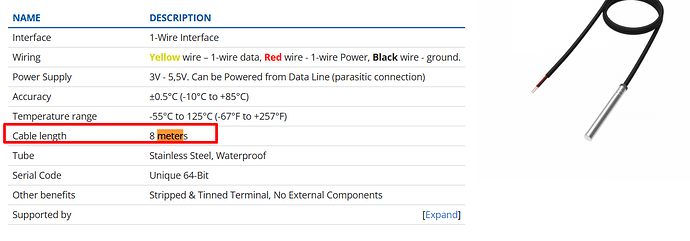

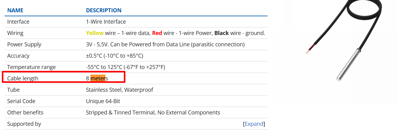

For the 1 wire temperature sensor, the cable length should be up to 8 meters: 1-Wire Temperature Sensors - Teltonika Telematics Wiki
