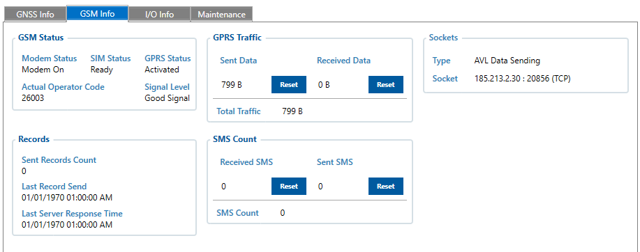

So DNS is already set?
You can try to send the web_connect command to the device and see if it reports to FOTAWEB.
Based on your screenshot the device is trying to connect to your server.
You can double-check your SIM subscription if you have enough data usage.
If the device connects to the FOTAWEB meaning there is no issue with the device and with the SIM, the issue is with your server.

Please check if FOTAWEB IP and PORT are whitelisted from your SIMCARD provider.
