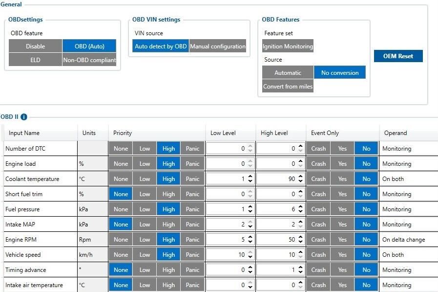

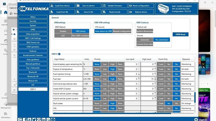

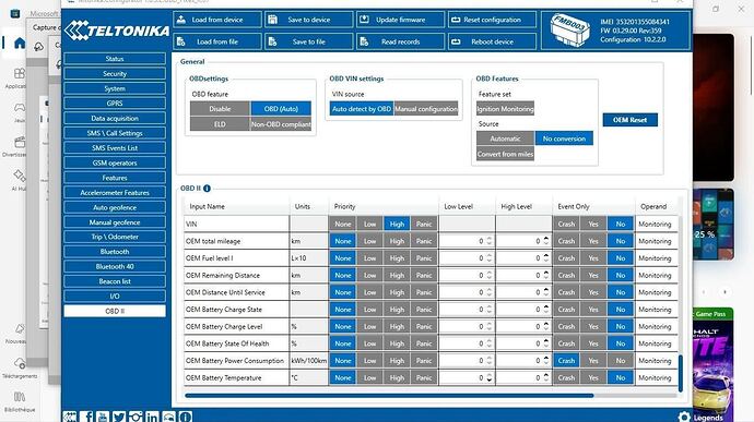

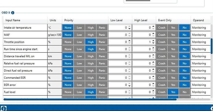

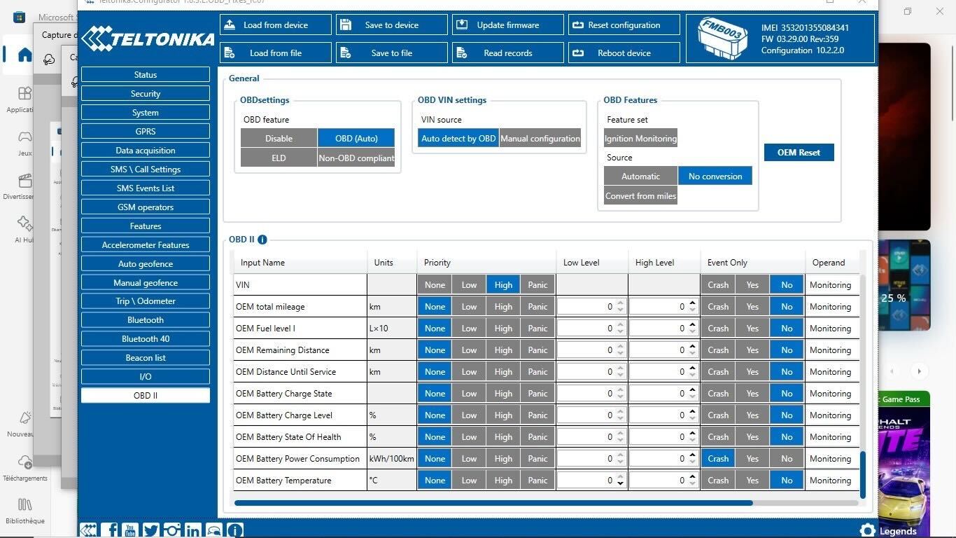

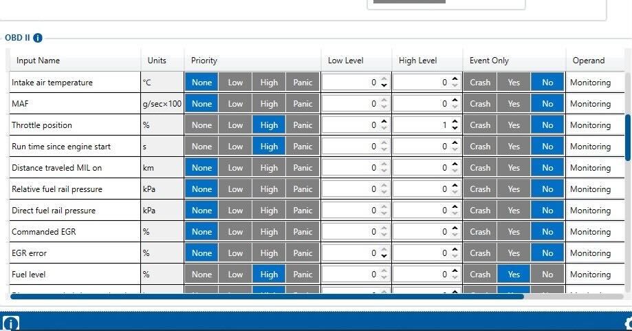

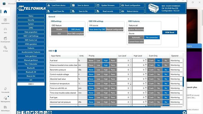

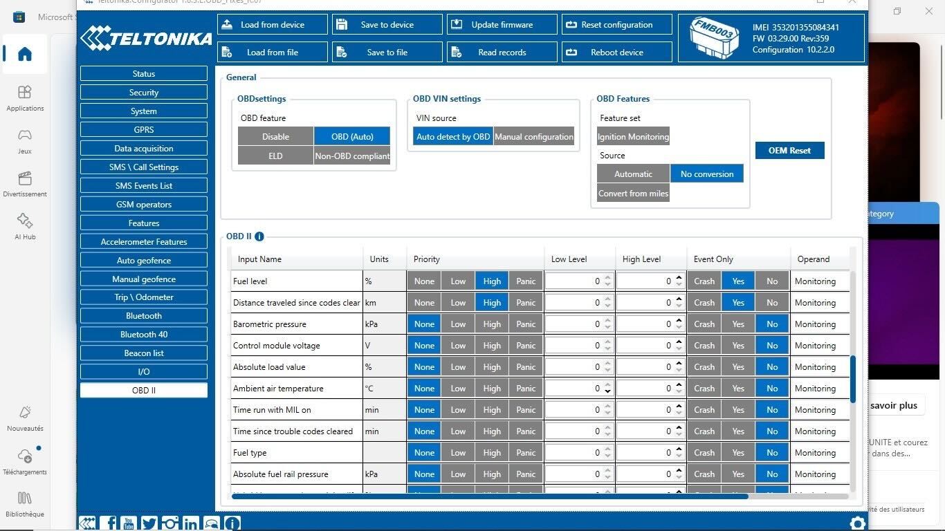

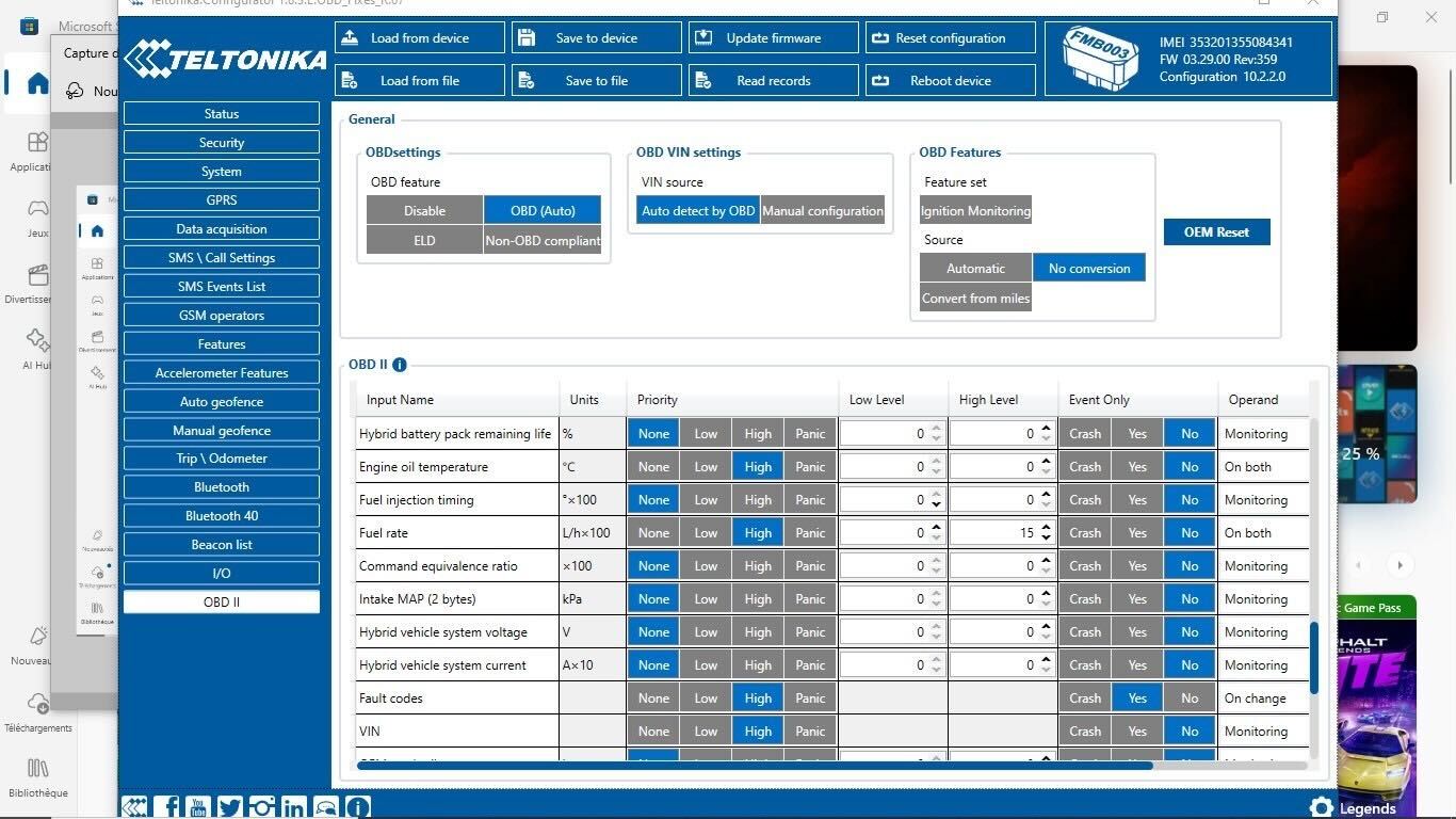

Hello everyone, I’m working on a project where I use an FMB003 with an MQTT broker. But I can’t view the data checked in Teltonika configurator. For some AVL ID it does not correspond. Here is the data that AWS IOT retrieves.

But there is a lot missing and I would like to see them in real time.
I would like to have your help! Thanks
Hello @limer,
I hope you are doing well. Some parameters might not be retrieved as you have set them to Event Only, meaning these records would only be added once the scenario has been triggered.
On the other hand, from the screenhost you have provided, it seems that there is no data available on the parameter that your server might be filtering. I suggest you check the AVL ID list from the device’s raw data to confirm the records received from the device.
More information about the device AVL ID list can be found on this link: FMB003 Teltonika Data Sending Parameters ID - Teltonika Telematics Wiki
