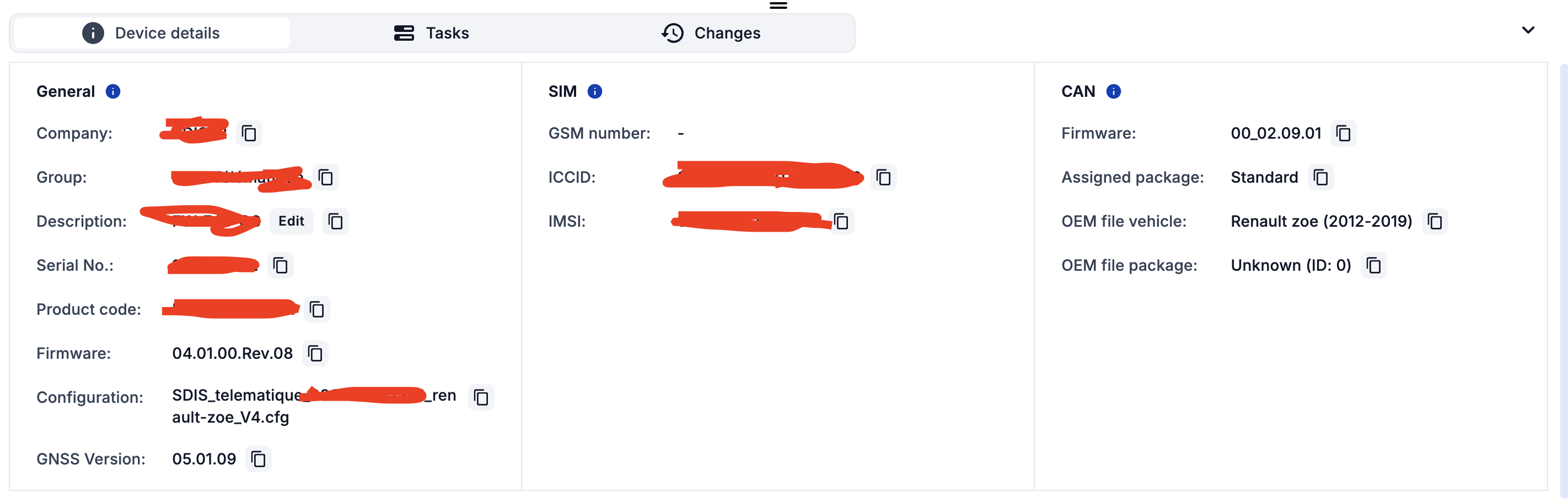

To give you more details on what has been done on my side:
  • The appropriate OEM configuration file has already been uploaded and applied via FOTA Web for the correct vehicle make and model.
  • The device is currently running firmware version 04.01.00.Rev.08.
  • I have also updated the CAN chip firmware to the latest available version.
Despite having completed all of these steps, the device is still reporting a value of 4%.
I have attached a photo/screenshot of the current configuration set on the device at the bottom of this message for your review.
Could you please advise on what else might be causing this issue or what further steps I should take?
