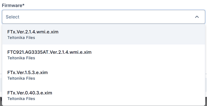

it looks like I am facing the same situation with my FTC921. Trackers. The current version with a whole lot of bug fixes is 3.0.8 however on FOTA it does not give me the option to do so it is kept at 2.1.4 very frustrating considering how buggy this firmware is and rollback is not possible. Can someone please point in the right direction to get this resolved?
