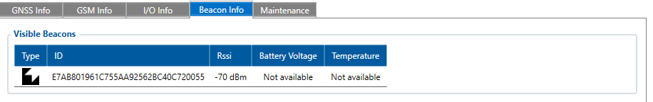

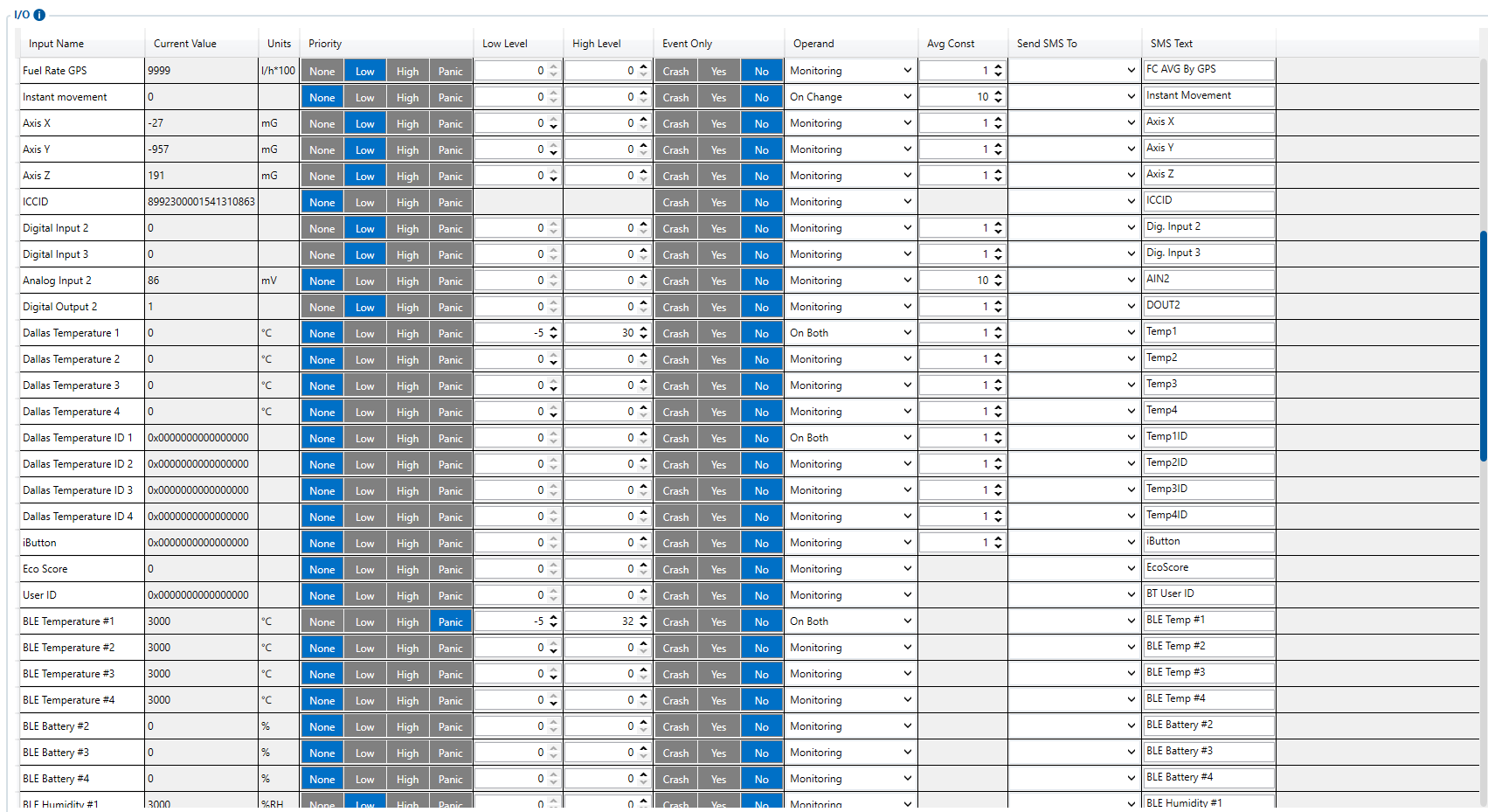

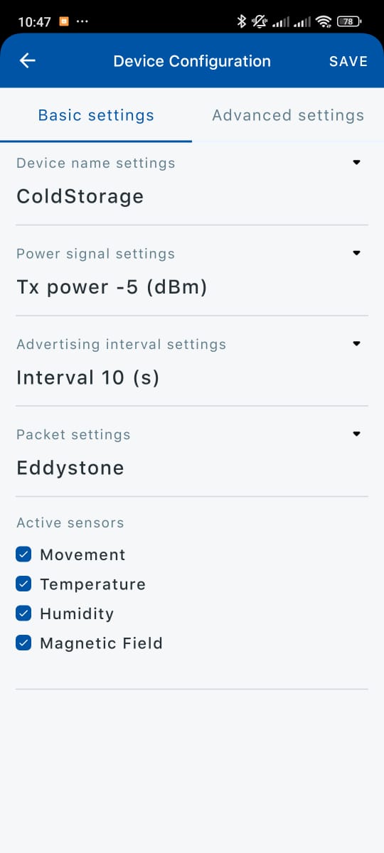

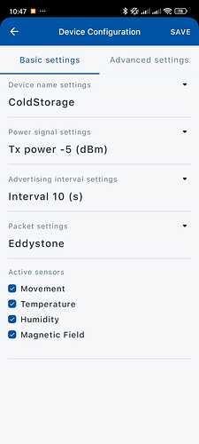

I am using EYE SENSOR with FMB 120 (Firmware: 3.27.13.Rev.03). Sensor Connected successfully with fmb120 but not showing on Configurator niether on AVL data.
