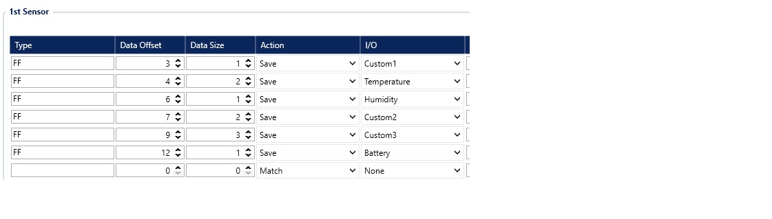

I have a eye sensor connected to a FMC650. The temperature and humidity sensors works, but the magnet sensor doesn’t. What Data ID, and Data size, do i need to configure on the FMC650 to detect the magnet? The Eye sensor is configure Packet settings EYE Sensors.

the problem is the default preset of eye sensor is the photo:
the values don’t match in state and where is the presence sensor ? custom 2?
and what is the length of each value?
