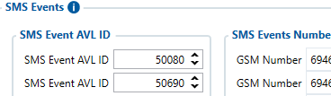

I am trying to set it up so that it sends an SMS if the external battery voltage drops under a set value. As well as, if the internal LiPo battery drops to 20% or lower.
These are my current settings :
I am switching the external battery from 24v to 12v, which the device should detect and send the SMS via the first event, but it does not seem to be working.
I suspect I have either misconfigured the Low/High parameters or the AVL ID. Any help would be appreciated

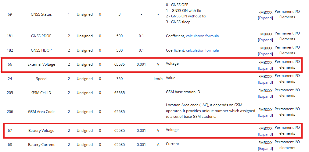

Happy New Year! Kindly use the AVL IDs mentioned below for the parameters you wish to receive SMS.
Full list can be accessed on this link: https://wiki.teltonika-gps.com/view/FMB204_Teltonika_Data_Sending_Parameters_ID
Hope this helps.
