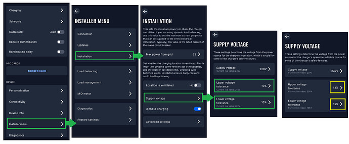

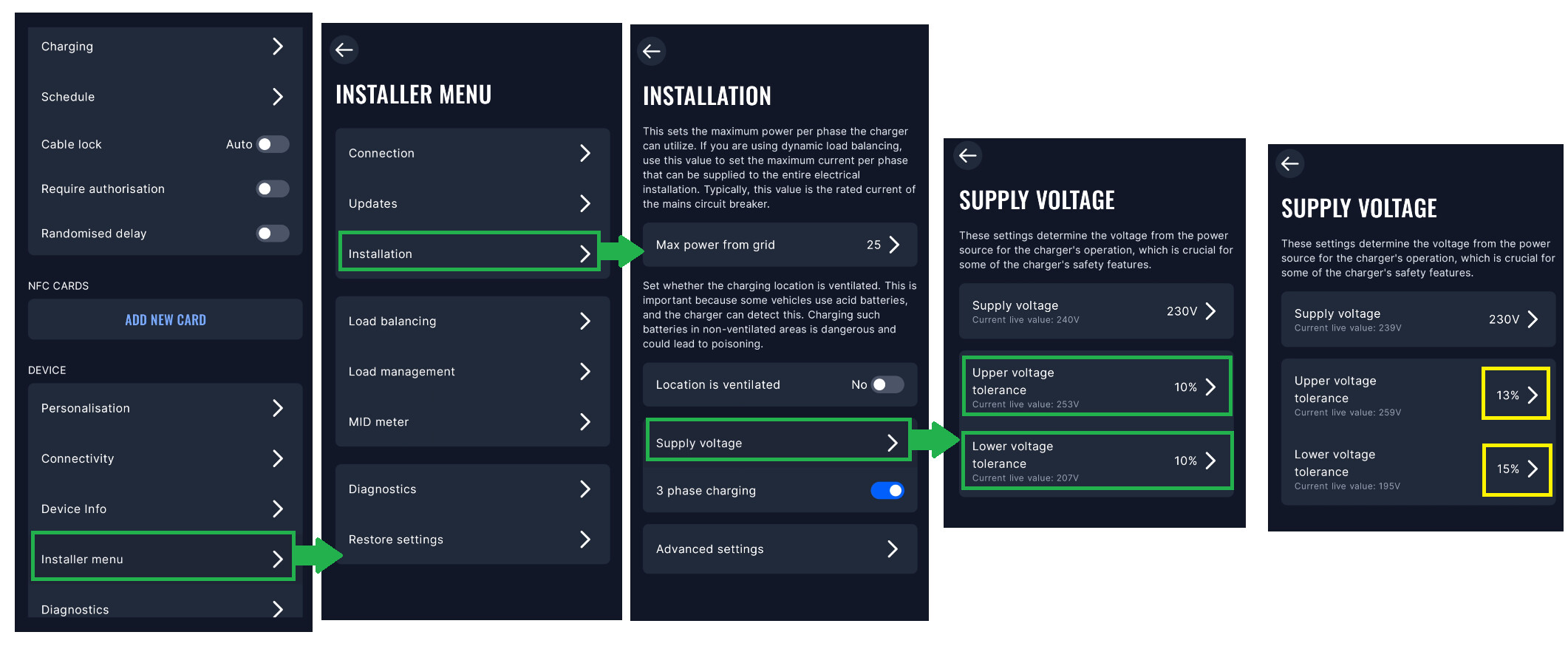

What I would recommend to do is to check live parameters (in settings > diagnostic tab) during the sunny day when this error happens and check what voltages you see and what it’s there under import/export.
By the default tolerances are 230V + ~10%. If it’s gets close to tolerance range on at least one phase, follow instructions below:
If tolerances stay in range or adjusting them does not help, please send us datalog file from troubleshooting section.
