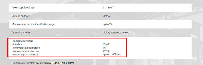

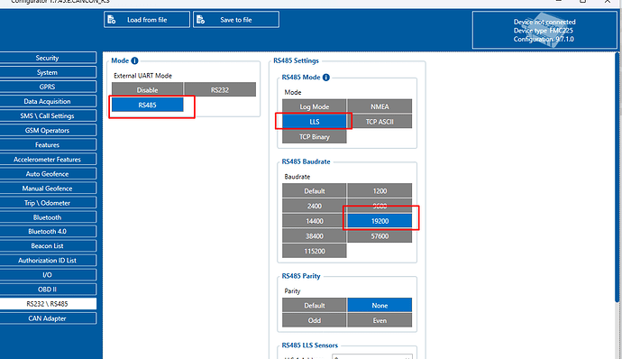

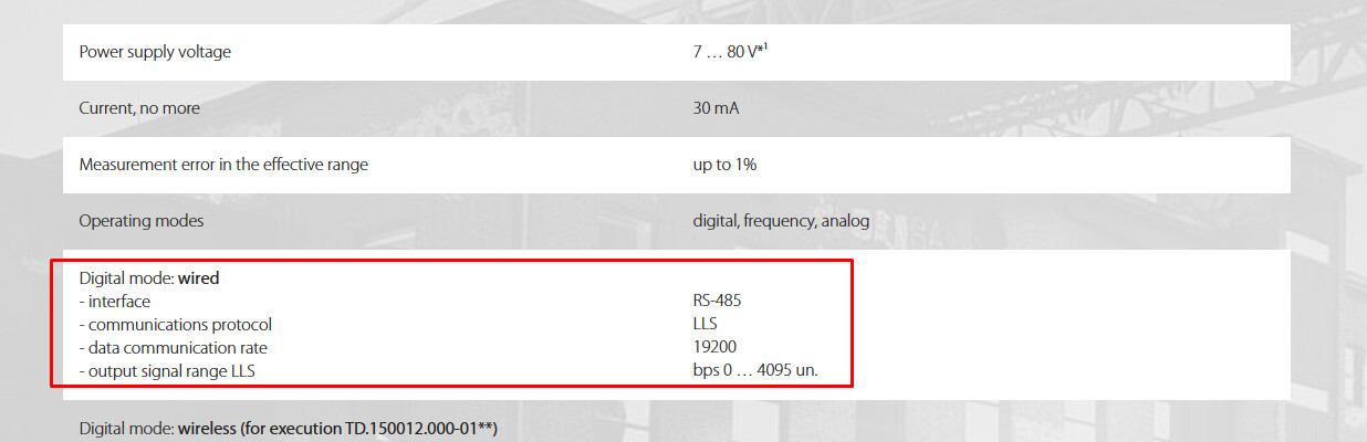

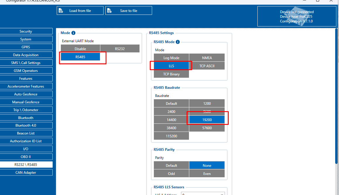

Based on the datasheet of the sensor you can use the FMX125 device
Please check the screenshot below
Reference: FMB125 RS-232 and RS-485 - Wiki Knowledge Base | Teltonika GPS (teltonika-gps.com)
