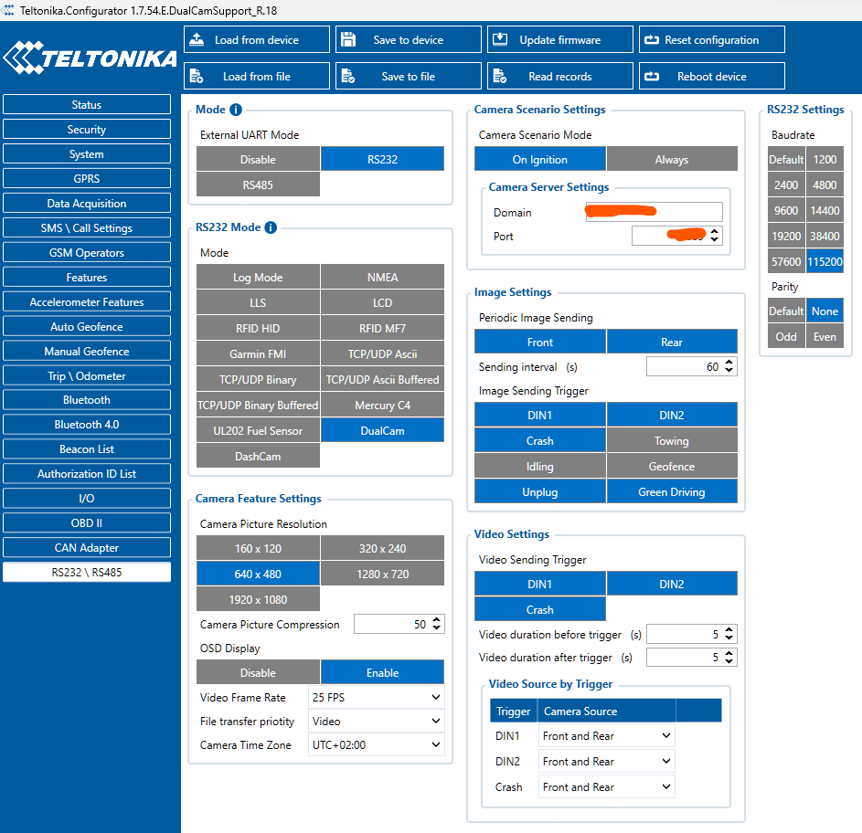

camgetver responds with V2.2.3 on both cameras, my FMC125 is running on firmware version 03.27.13 rev. 662. DIN1 is constantly HIGH for testing, but no video ever transmits to the server. See my settings below.
Do I need a different firmware version on the FMC125 or Dualcam?

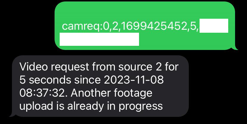

When requesting video from an FMC125 with Dualcam I keep getting this response: “Video request from source 3 for 1 seconds since 2023-10-30 16:30:52. Another footage upload is already in progress”
This happens regardless of how long I leave it without requests, after power cycling the tracker and Dualcam, watching the receiving server making sure there are no pending uploads.
I’m using the windows based server software I found on one the your Wikihow pages. Does this software allow for retrieval of video from a Dualcam?

No matter what we do, we keep seeing this response from the Dualcam when trying to trigger remote video upload. After weeks of testing we’ve not been able to successfully trigger a single video upload. Photos come through fine.
This after rebooting the FMC125 and Dualcam, checked that cameras status’ are 3, checked SD cards, disabled all photo uploads to clear the way for videos only. Keep getting the same response.
use these below command before when requesting for video download and also make sure to use the correct pattern (Command) for video request
camget_restart: 1
camget_restart: 2
Hello Usman, thanks for taking the time to respond. This is one of the many things I’ve tried, made no difference.
Do you use Dualcams with reliable success?
yes! the same issue happened with me, and this command somehow work out for me and download the video request
