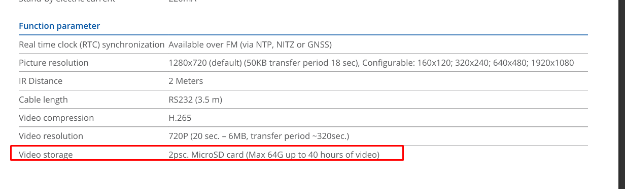

I use a connected FMC650 and Dualcam device. I tried to request a video via SMS but got the reply “NOT ENOUGH SPACE IN PHOTO BUFFER”. Previously the SMS used was working fine because I was using a 64 GB microSD and now I tried using a 128 GB microSD and then this problem arose, whether the dual cam device didn’t support 128 GB microSD.
I use Sandisk Extreme Pro microSDXC A2 128 GB.
Please help
Good day, dualcam only supports 64GB micro SD card
Reference: 631370_Datasheet_Teltonika_DualCam_V1.2.pdf
Best Regard
Maynard C
