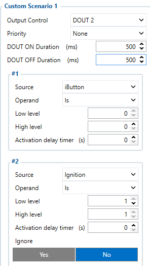

We tested an FMC130 with customized scenarios for a specific need: a buzzer connected to DOUT2 that sounds as soon as the ignition is turned on to force the driver to identify themselves via a 1-wire RFID reader.
This part works well.

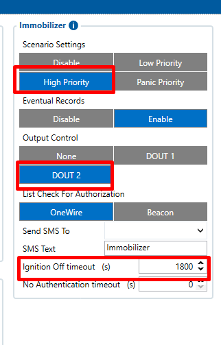

Immobilizer feature will help, use it instead of custom scenario

Hello, and thank you for this feedback, Maynard.
The Immobilizer scenario is already used with DOUT1 on a relay for the immobilizer.

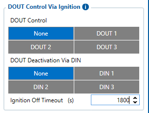

Could it work with this:
Thank you
Hi @Momo
This will only be deactivated via DIN not ibutton/1wireRFID
