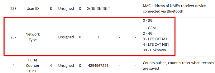

I hope you are doing well. FMC125 is a 4G device which means the connectivity would be in 4G, otherwise you can check from this parameter on the device related to the current Network Type of the device.
An video send of rear camera with 20 fps and 640*480 take me almost 4 minutes to transfer while i am in 4G , could you please help me finding where could be the problem ?
