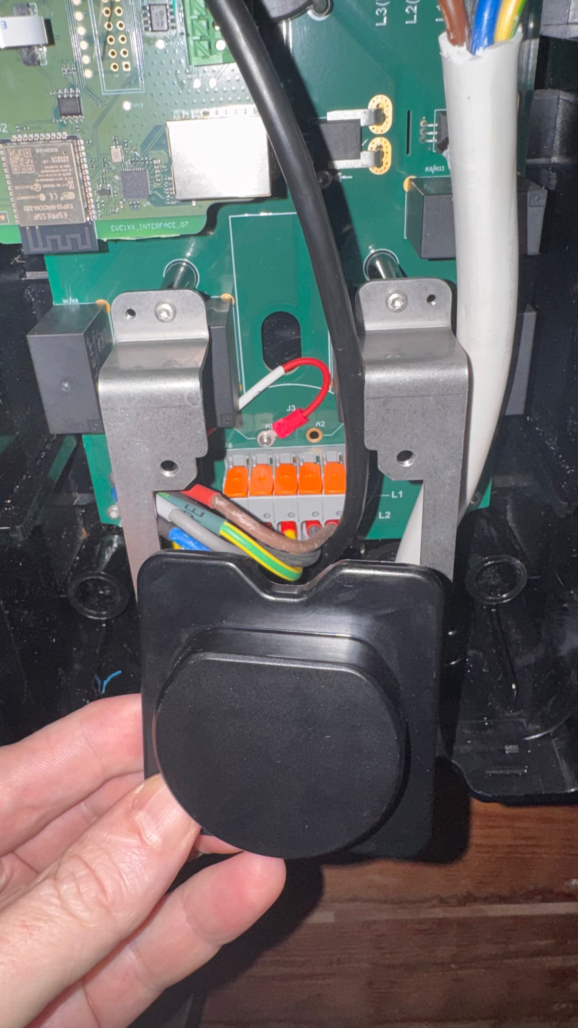

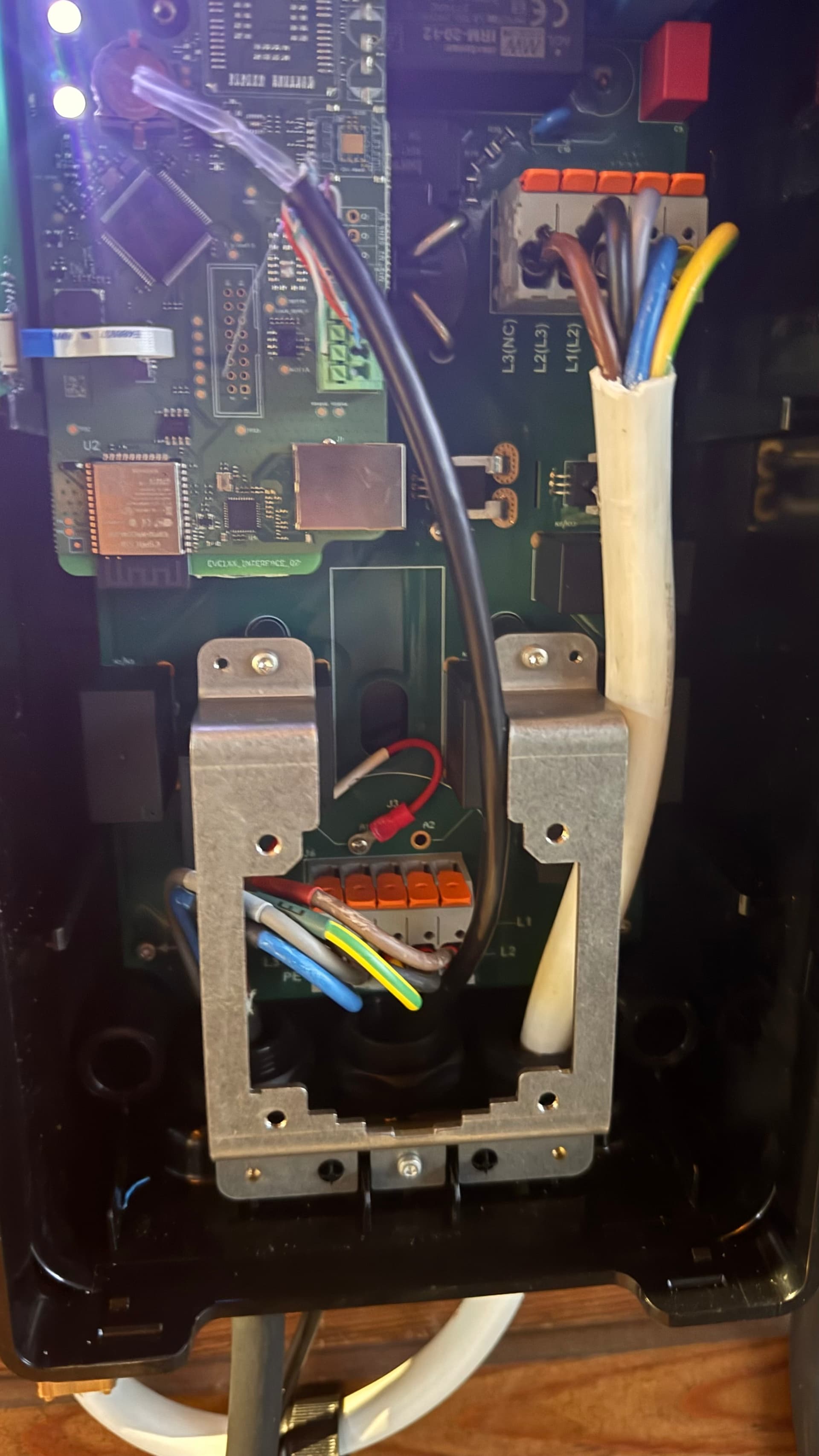

Welcome to the community! If you’re using a cabled version in that case is it possible to remove protective DC lid below the AC port before inserting the charger. I’m assuming the connection is at fault here.
Hello, do you me to take off this lid and check the connections of charging cable? Visually it all looks ok.
