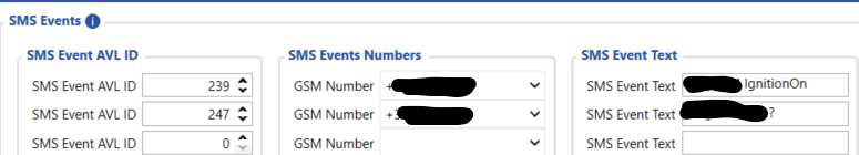

You can use the SMS events feature to create an SMS event when the Crash detection AVL ID is triggered. Please find more details to configure the SMS events in the wiki link given below:

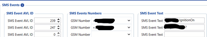

Thanks I did that and found out that Crash AVL event id is 247. I’ve filled the values into SMS Events section, but still not working:

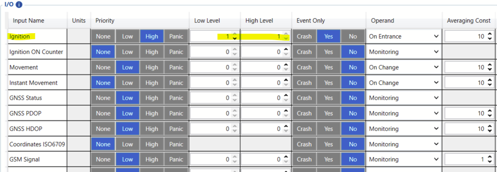

First event / SMS notification for IgnitionOn works ok! Probably because I activated an Ignition event in I/O section:
But in this I/O section, there is no Crash event. There is “Crash button” in column “Event Only”, but not sure to which I/O should be attached in the first column?
