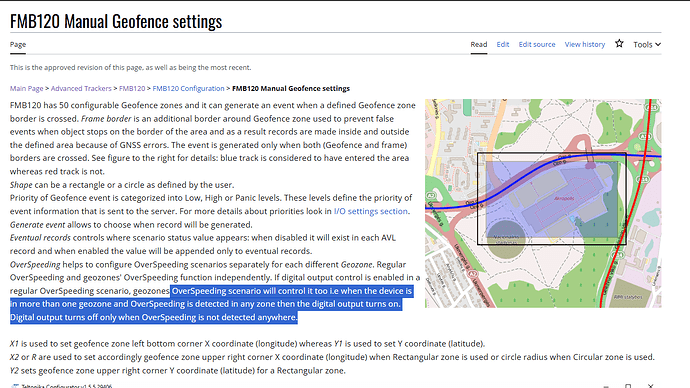

Good day, please find this link for the FMC130 wiring diagram: [Wiring-scheme-FMC130.jpg (2000×1355)] (https://wiki.teltonika-gps.com/images/0/0a/Wiring-scheme-FMC130.jpg)
Note: That the DOUT is giving negative voltage.
Wiki: FMB120 Manual Geofence settings - Teltonika Telematics Wiki
Enable the overspeeding scenario and make sure that you configured the manual geofence for each zone.
