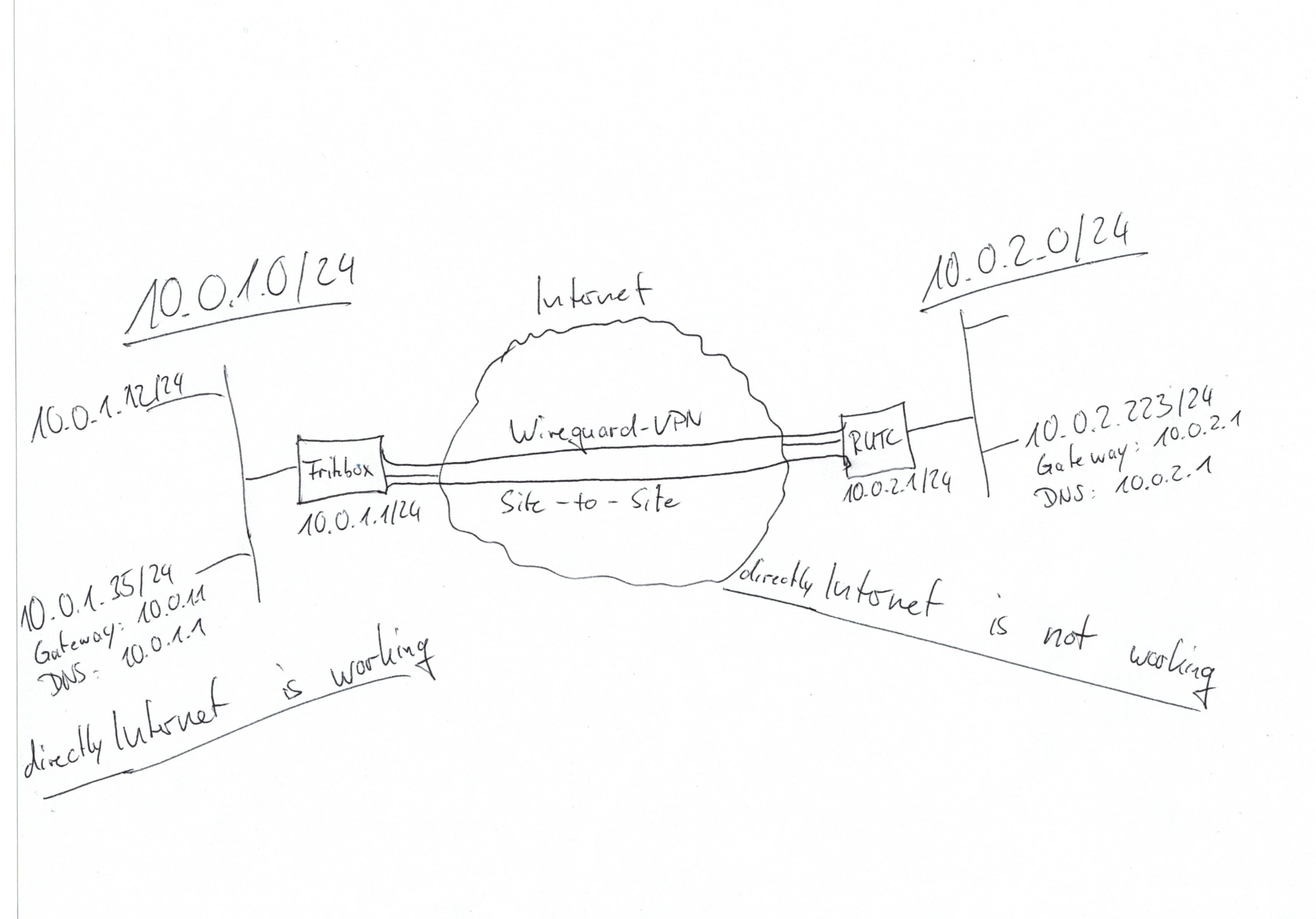

Please do a drawing (a handwritten one will do) with all the addresses/netmasks mentioned and post it somewhere.
Where is 10.0.1.0/24 exactly ?
As I said, the two networks (10.0.1.0/24 & 10.0.2.0/24) can communicate wonderfully in both directions.
The network behind the Fritzbox (10.0.1.0/24) also connects wonderfully directly to the Internet via DSL. However, the network behind the RUTC (10.0.2.0/24) does not have direct access to the Internet via mobile (4G/5G) and I have no idea why not.
I think it’s due to some firewall setting that LAN is not allowed into the WAN or something…???
Ok it is clear now. You can’t use 10.0.2.0/24 addresses for the wg tunnel the routes will be trashed the RUTC will not be able to answer to any packet.
Either change the wg addresses, or change the lan address/netmask of the RUTC (easier ? 10.0.3.0/24 will do).

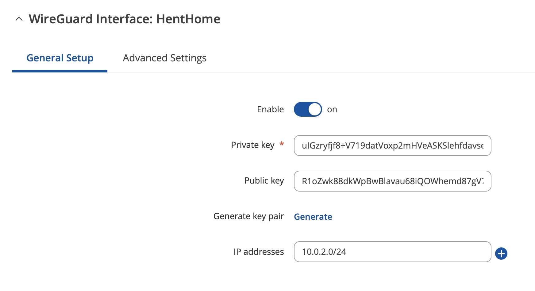

What is Wireguard now 10.0.2.0/24 (in my case) when my local network is now 10.0.3.0/24. Where or what is the 10.0.2.0/24 network now?

Wireguard doesn’t give the choice, a tun interface is required, with its own IP address/netmask.
So the local IP network is not 10.0.2.0/24 it is 10.0.3.0/24 as you can see with “ifconfig br-lan”.
10.0.2.0/24 is the network of the wg interface, do a “ifconfig HentHome” you’ll see it.
