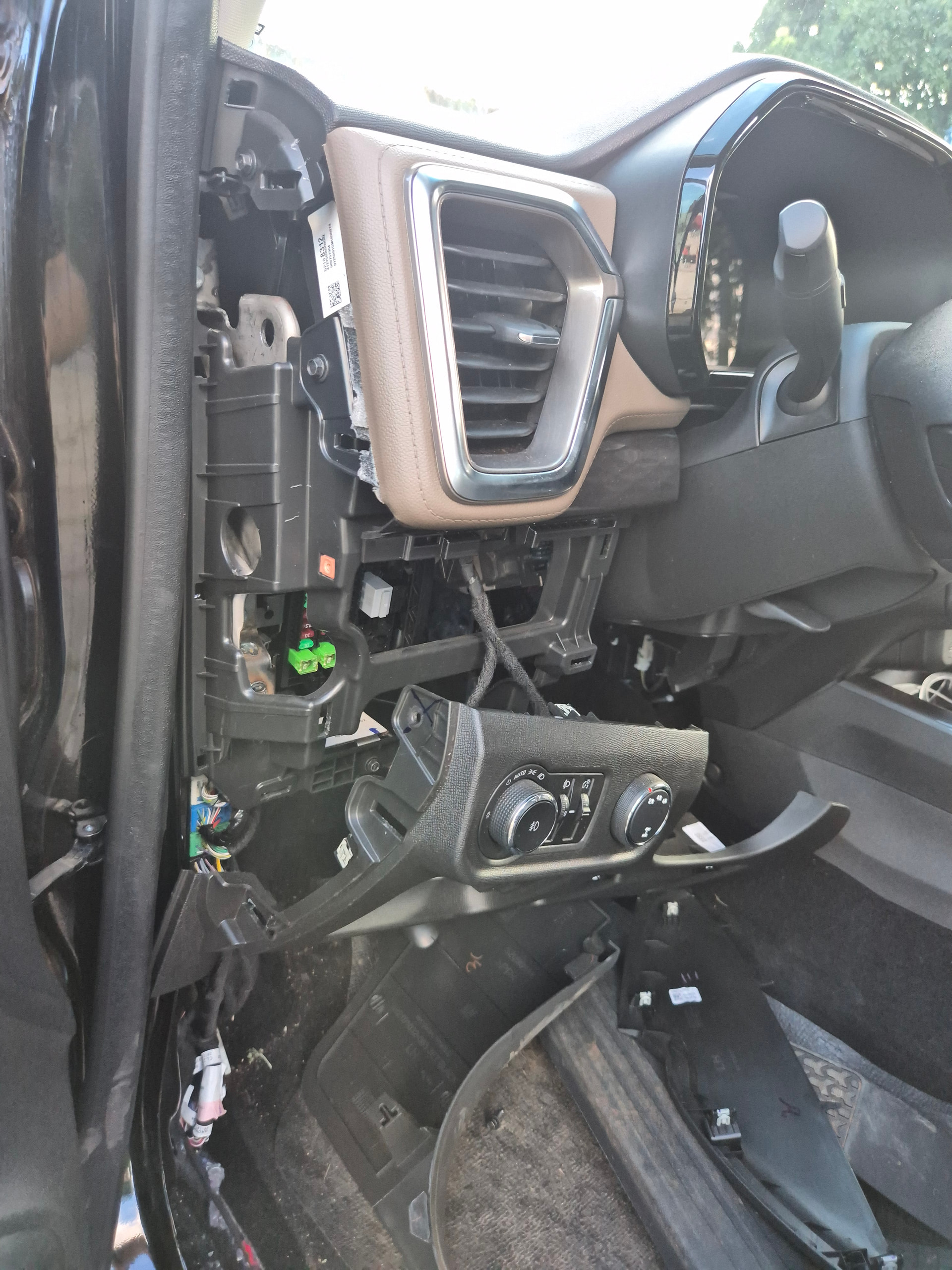

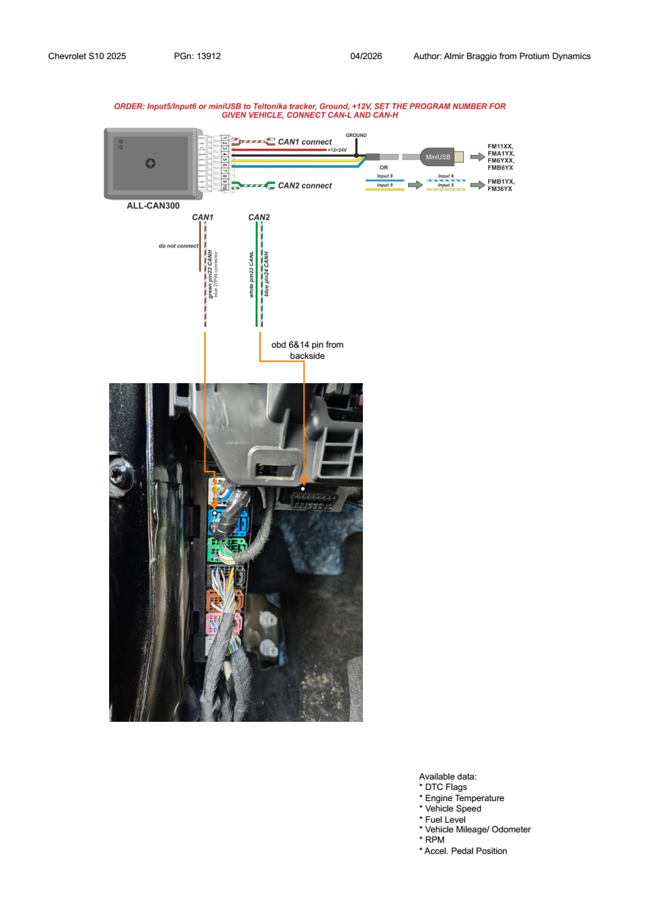

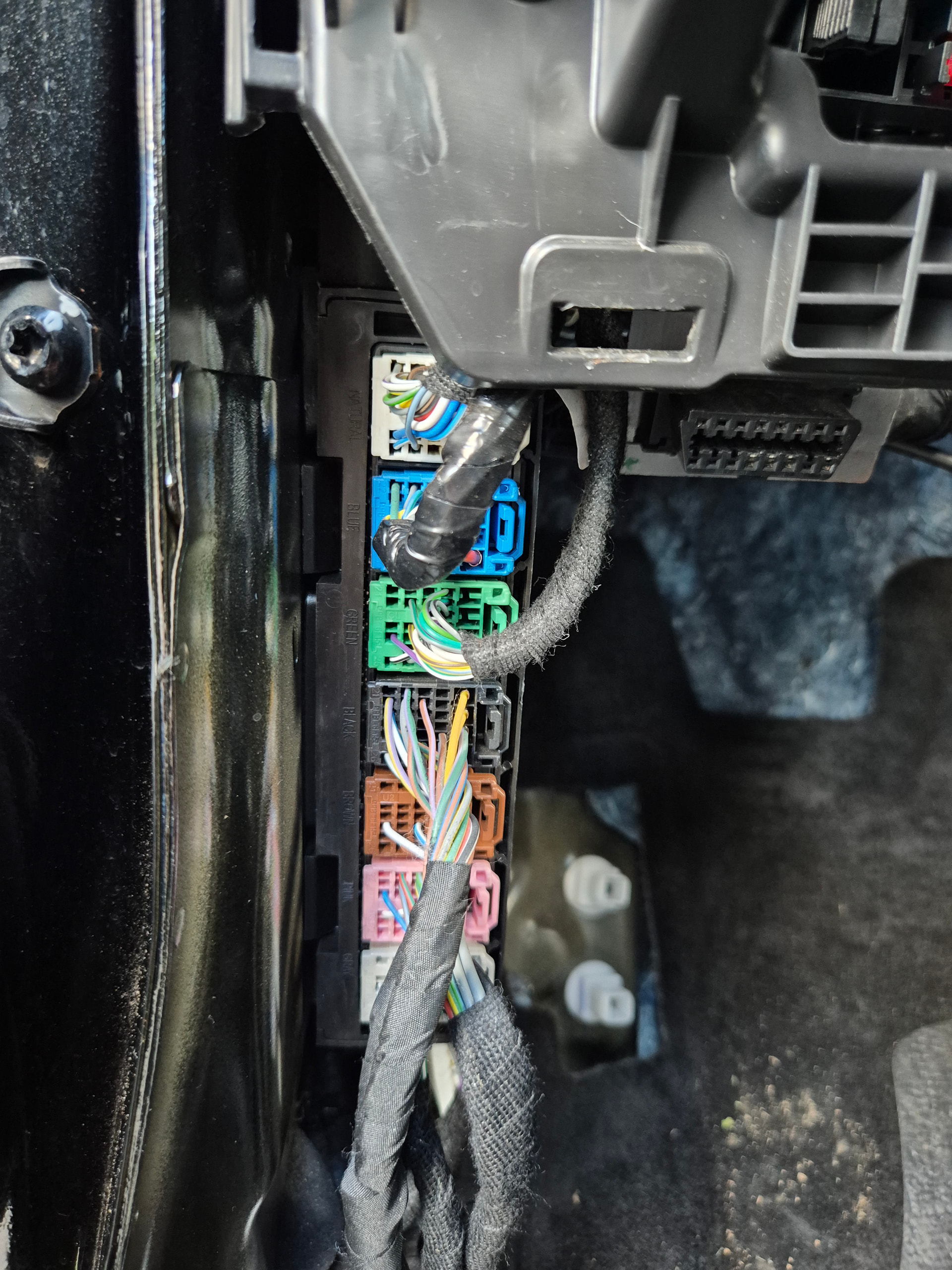

Below I am attaching the ALLCAN300 installation schema for the 2025 Chevrolet S10 (Brazilian model).
This diagram did not exist, so I based it on the Chevrolet Colorado diagram.
Program Number: 13912
Available data:
  • DTC Flags
  • Engine Temperature
  • Vehicle Speed
  • Fuel Level
  • Vehicle Mileage/Odometer
  • RPM
  • Accel. Pedal Position
I hope this helps someone.
