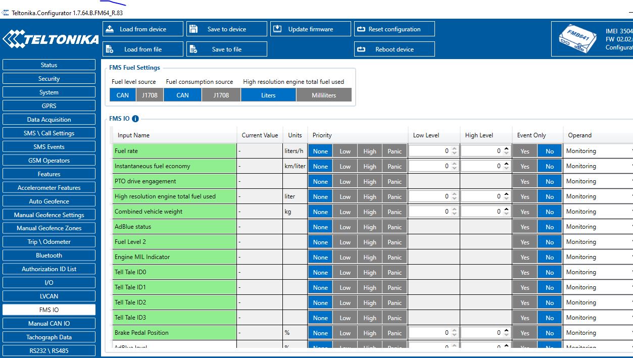

Hi thanks for your information, However, when I retrieve CAN bus data in Teltonika Configurator, it appears as below, on the left (in green), but the values of the CAN bus data do not appear? Do you have any suggestions?
You had try change baudrate of CAN line on which you getiing data from FMS ( in MB actros it can be Auto/250/500 if you connected device like in Link you get)
