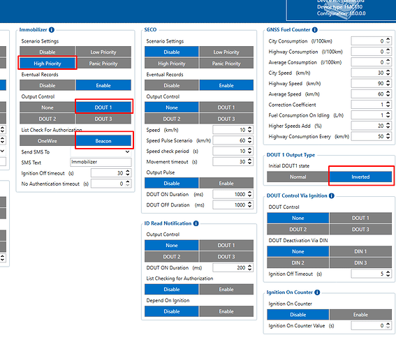

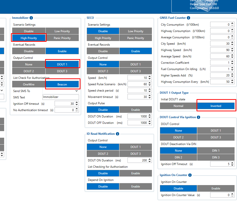

Try to do this work around, if you use case is only to activate the DOUT if the beacon ID is detected by the device then you can try to use the immobilizer scenario and the inverted DOUT feature.
Configured like the screenshot below:
For this solution the ignition should always be ON ( DIN 1 connected to the Power source ) so that all the time the DOUT 1 will be 0 once the ignition is connected and will become 1 once the beacon ID from the supported list is detected.

Hi Mr Maynard, thanks for the reply but we try this config already. It could work if we were using an ignition feed but we need a 2 wire install with movement detection. This solution wont work as the output is high all the time so relay energised all the time. Something so simple, I dont understand why we cant make this work? BLE beacon detected DOUT high. BLE beacon not detected DOUT low. Its so simple. Is there a version of the configurator where we can edit the parameters that we need?
