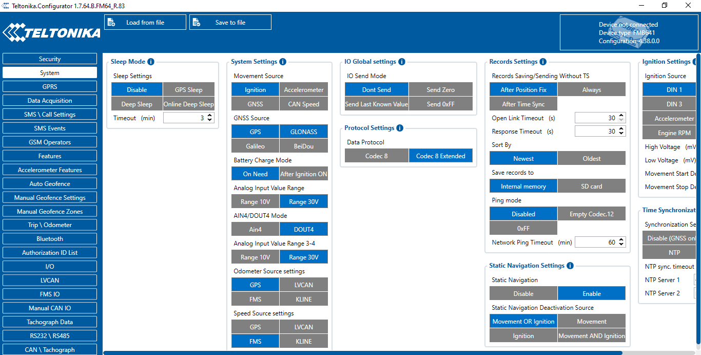

Hello @maulnrzky,
Good day! I believe you are asking about the Speed Source Settings on the Configuration, you have 4 Options to declare what technology will be used for vehicle speed measurement.
In this case, I suggest you to use the Default setting GPS as speed source given that you are not using any external CAN Adapter (LVCAN200/ALLCAN300) or connected to the KLine/FMS of the vehicle.
For more information about the FMB640 System settings, you may refer on this link: FMB640 System Settings.
I hope this helps.
