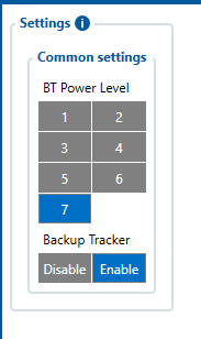

Hi @eirr_01

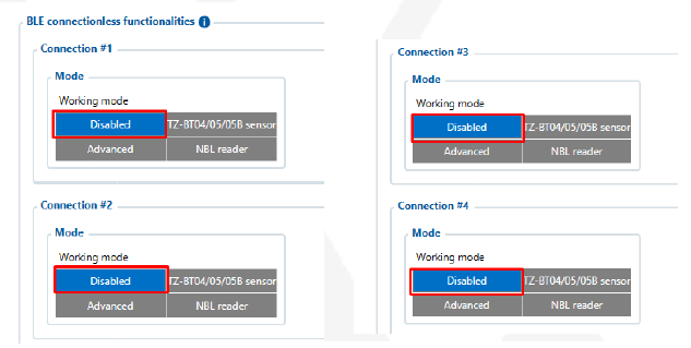

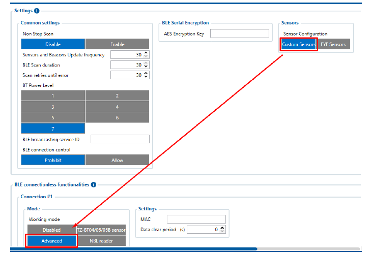

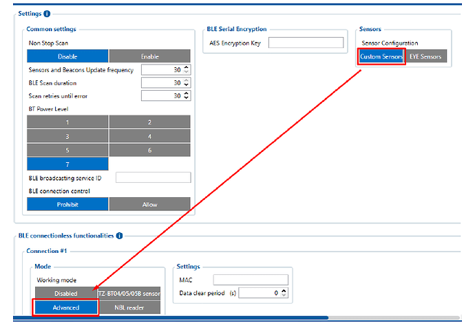

If the Backup Tracker option will not appear, make sure that you didn’t configure any sensor like the screenshot below.
Do not select any sensors and click Disable modes from the BLE connection so that the Backup Tracker option will appear.

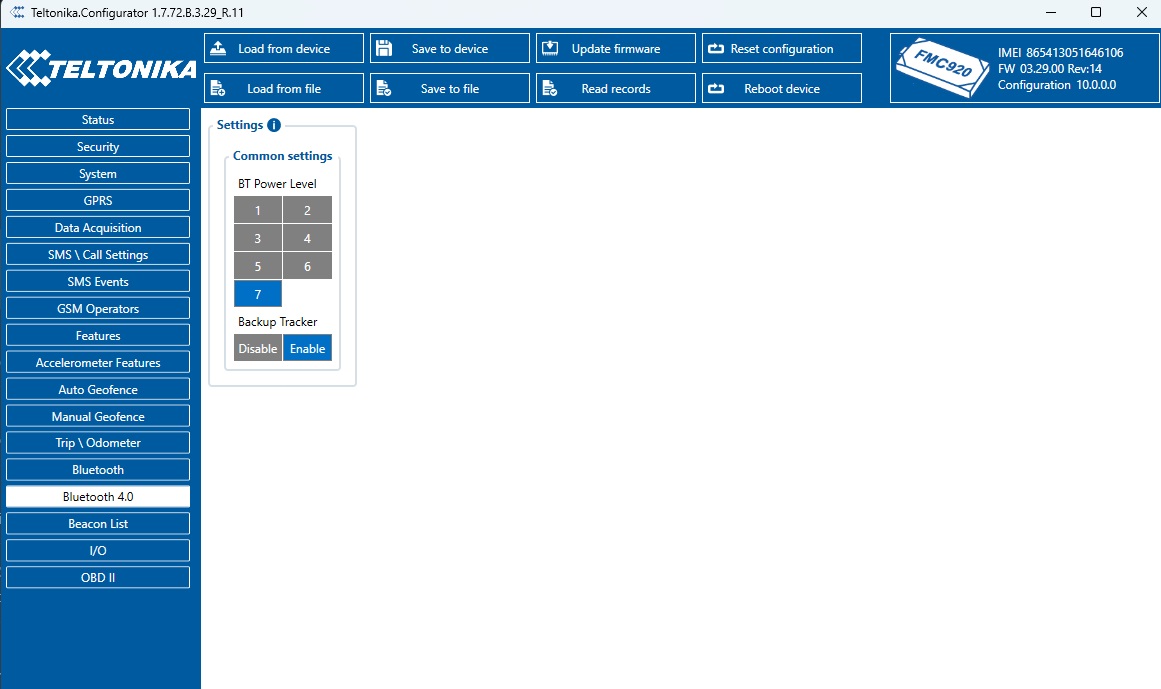

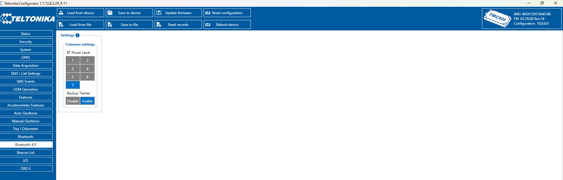

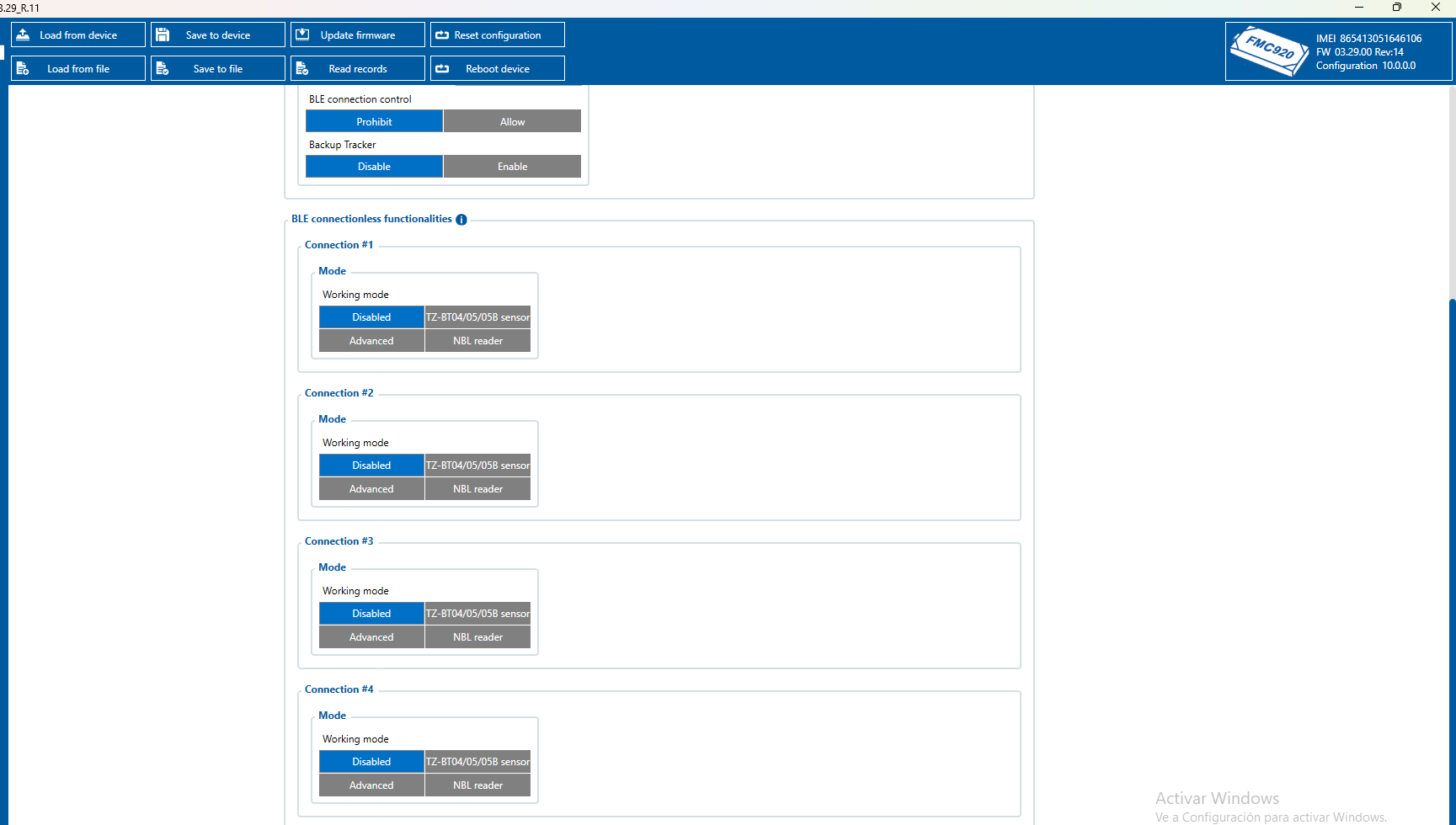

yes but after i do that, does´n show me this options
i cant select main tracker or backup tracker
just show me like this

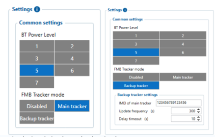

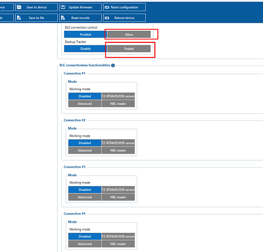

Hi @eirr_01
Good day, the screenshot below is only for the TAT140 or TAT100 device
And this is for the FMC920 device

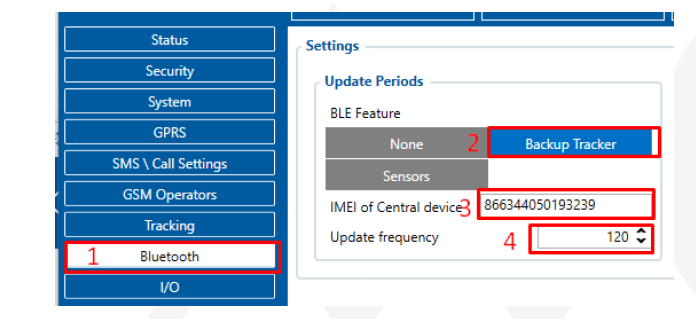

The main tracker is the FMC920 and the backup tracker is the TAT140 and TAT100
- Go to Bluetooth
- Select Backup Tracker
- Enter the IMEI of Central device that will be paired with TAT140 (FMC920)
- Configure Update frequency.

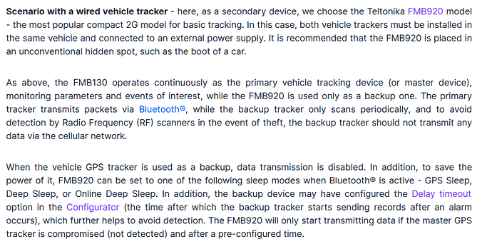

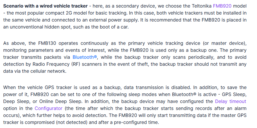

Here says that FMB920 also could be a secondary device

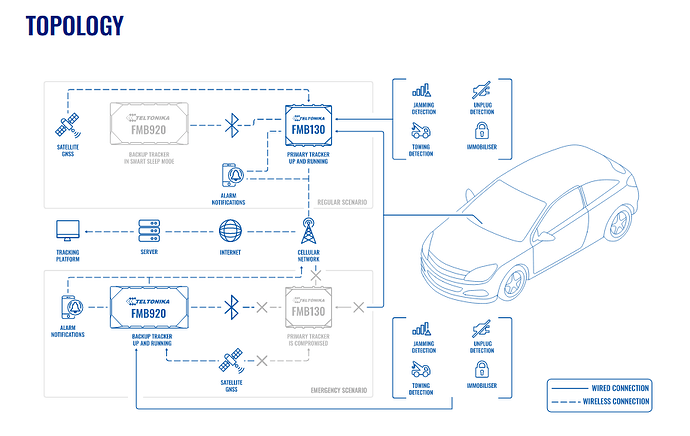

and here is the topology
