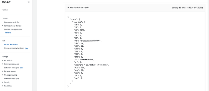

I am trying to send data from an FMC-125 device to AWS Cloud using the AWS IoT Core service.
However, the parameters received in IoT Core have different names than those listed in the Teltonika Wiki.
Could you help us understand why the variable names differ?

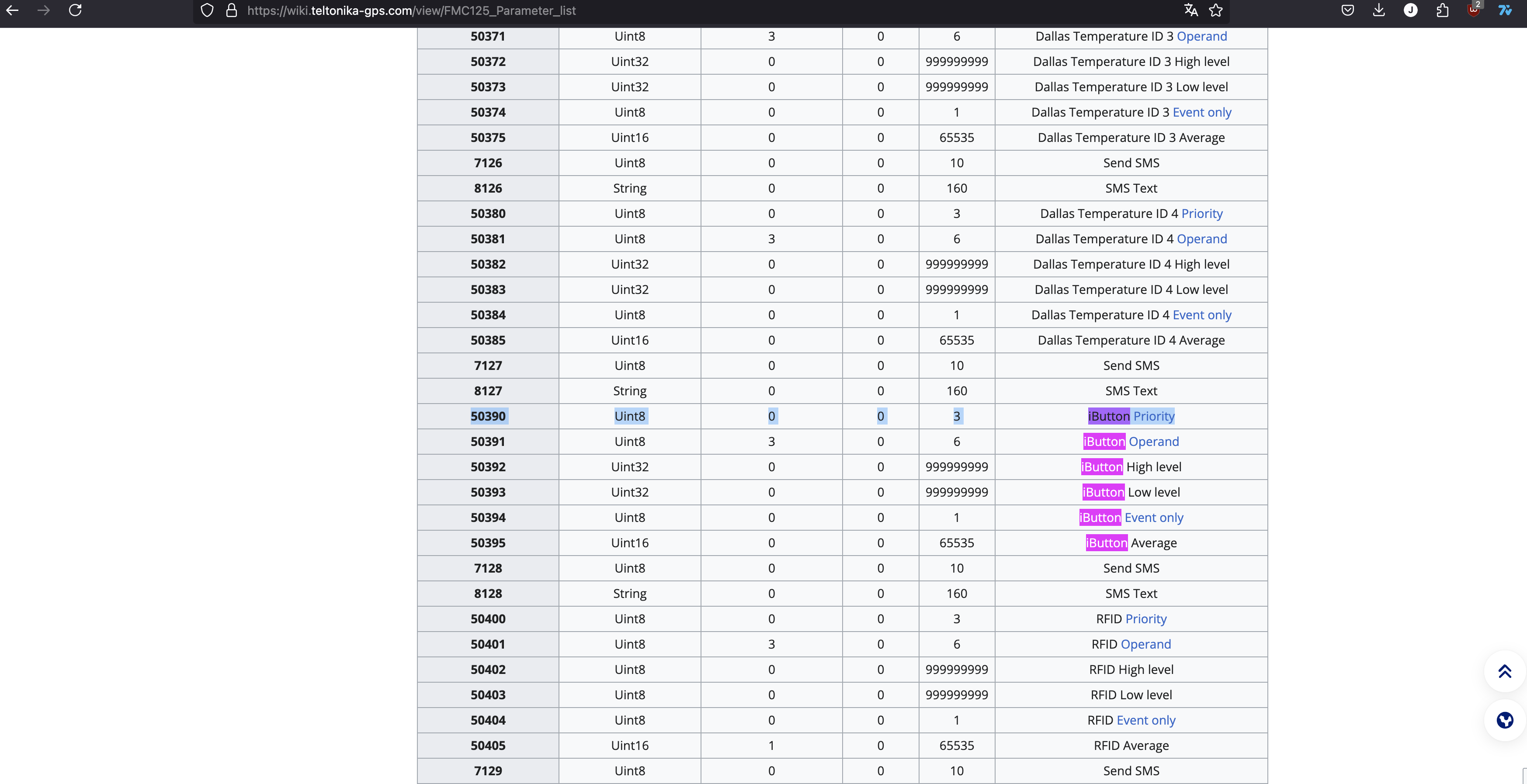

Please check this link: FMC125 Teltonika Data Sending Parameters ID - Teltonika Telematics Wiki

Thanks Maynard. I have the following parameters that are not in the wiki:
|ts| timestamp?
|pr|?
|latlng|?
|alt|altitude?
|ang|angle?
|sat|satellites?
|sp|?
|evt|?

Please find this link: Codec - Teltonika Telematics Wiki
sp - speed

Good day, custom variables can be added on the server side like linking the device IMEI to the license plate.
