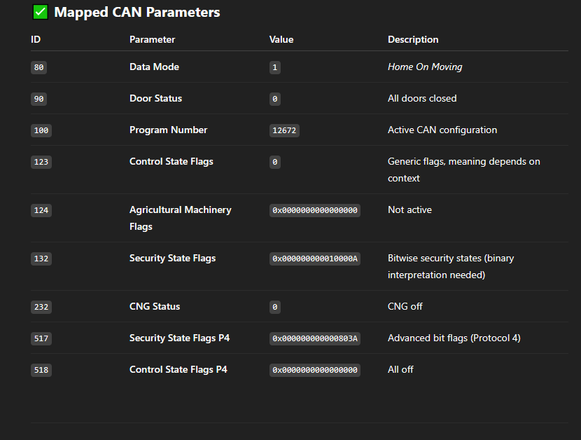

Hello @geff.lang,
I hope you are doing well. Have you received other parameters from the device?
Can you confirm if the ALLCAN300 parameters were enabled? Based on the logs, these are related to the SMS commands sent to the device.

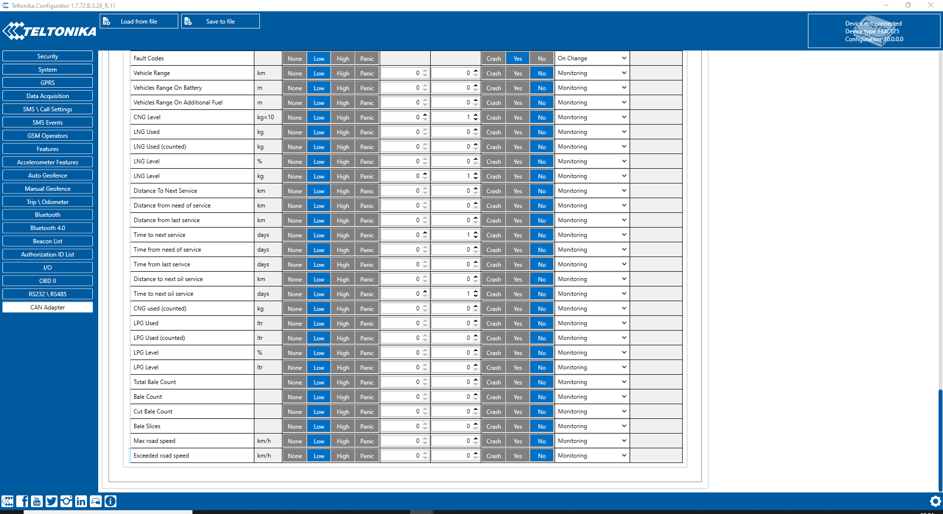

Hi @Patrick_Sangalang, thanks for your reply and your support. We have replicated your configuration with all the parameters. Two new appeared: 90 door status and 100 program number. Nothing else.
We are looking to get all the possible parameters from these devices.

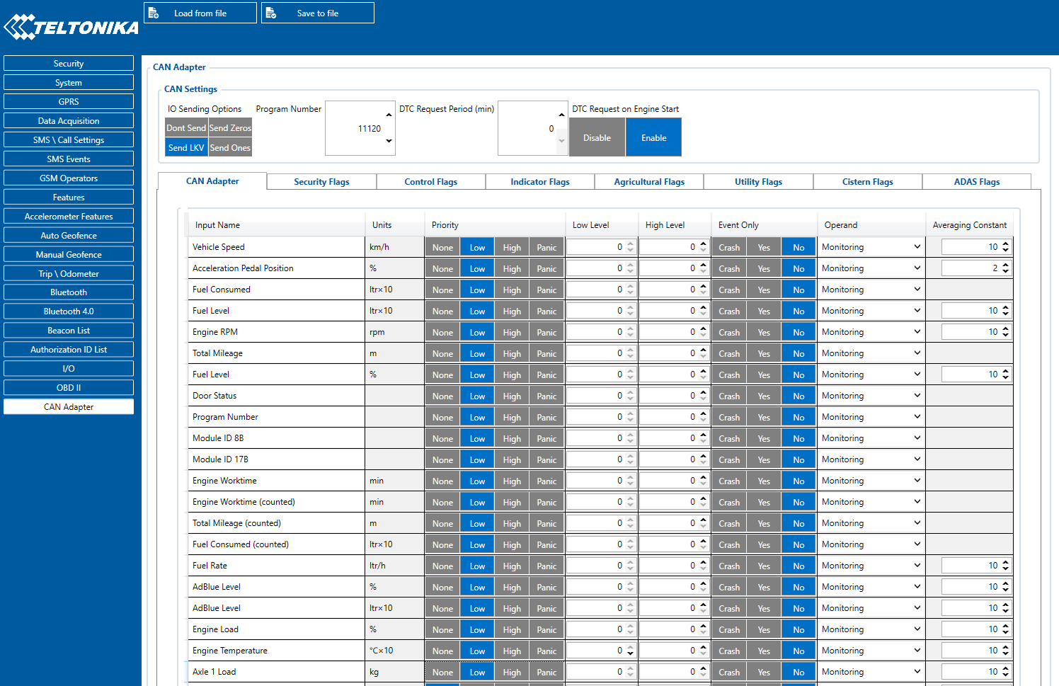

Hello @Patrick_Sangalang,
We tried using different program numbers and finally got it working with the FMC125.
However, we’re still blocked with the FMC650. We installed the devices without the ALL-CAN, but we’re not receiving any data from the CAN at all.
