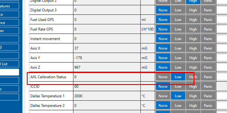

Firstly it seems that the accelerometer calibration is not taking into account the way the device is positioned (orientated). Is there an IO code that shows the calibration status? It seems to be 383 but its not appearing in the log data.
Secondly is there a way to reduce the amount of log data to only log on certain values changes etc?
Good day, please try to use the latest firmware of FMB920, FMB204 and FMB130.
To get the AVL ID 383 please try to enable the codec 8 extended.
And enable it from the IO
