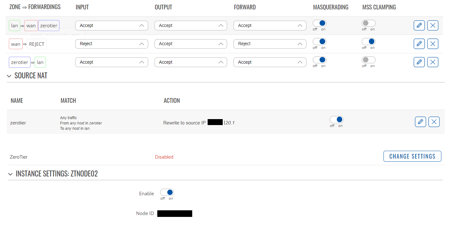

Under services ZeroTier shows disables, but the VPN instance is enabled and it is online when queried through the CLI.
I am trying to set up a small zerotier network and cannot connect to devices connected to LAN.
ZeroTier central is showing all routers connected and updating about every 1 minute.
I can ping from one router to the other using their LAN IP address (and vice versa).
But when I try and ping a device on the either routers LAN interface, it times out.

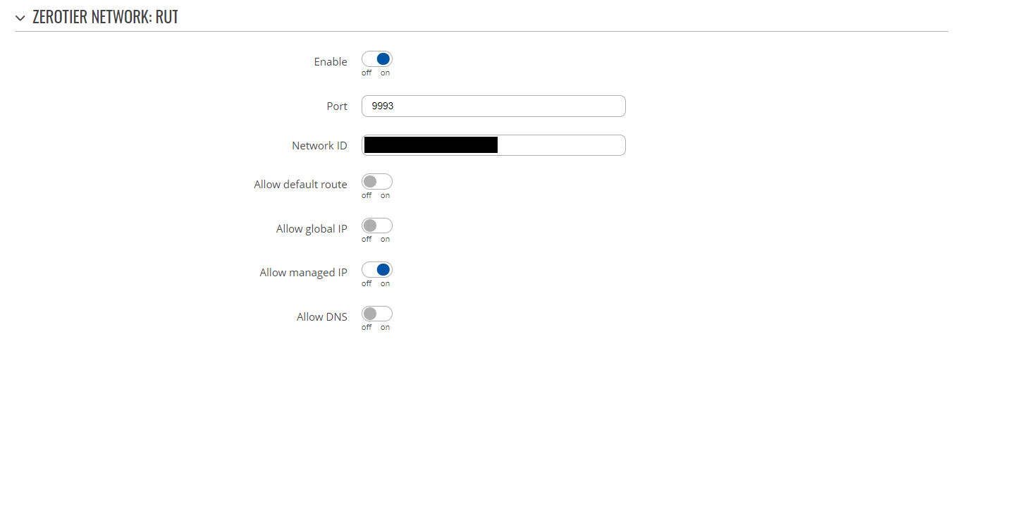

I tried following the ZeroTier configuration guide but my interface does not show bridge mode as an option.
Any assistance would be appreciated.
This is the view I get when creating zerotier instance
I do not have bridge mode available.
I have also set up managed routes for both RUT360 units in zerotier central.
There should be no need to configure SNAT or any other firewall rules. If you add a route to the LAN networks it should be reachable.
You have a couple of subnets with .20.0/24. Could you please clarify if those networks are identical? Make sure that they are on different networks.
Also, can you share an output of the ‘route -n’ command from your router and your PC? (‘route print -4’ on Windows)
