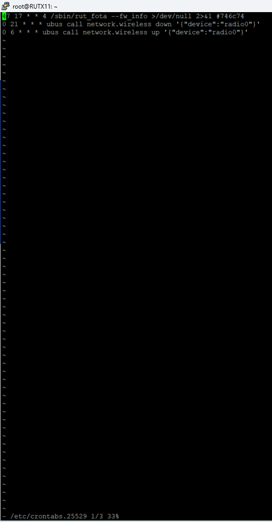

For this one, you can utilize the ubus commands and crontabs.
So let’s say, you want to turn off your WLAN at 9pm then turn it back on at 6am. To do this:
0 21 * * * ubus call network.wireless down ‘{“device”:“radio0”}’
0 6 * * * ubus call network.wireless up ‘{“device”:“radio0”}’
It should look similar to this:
After successfully adding the crontab, your WLAN will be turned off at 9pm then it will go back up at 6am. You can change the timings based on your liking. Note that the timings in crontab is in 24-hour format.
Hope this helps!
