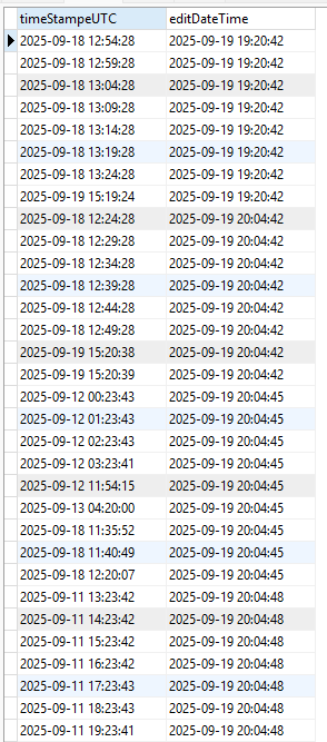

Dear Support ,
in case of the device was off for some period of time or due to network issues then the device is buffering the records and send them one time to server. my question is that when it sends the messages/ records why it is not on order like the old one first then the latest. you can see from below the editDateTime is when I receive the data but the timeStampUTC is the date of the message in imei records. you can see also how I make in the configurator the order by setting oldest first.
please help me since I am not getting right position GPS coordinates in right time
Hello @denholmyam,
I hope you are doing well. Synchronizing the records from your server end should be performed on the Platform itself. From the device perspective it would send all the records and it can also generate High Priority (Immediate data sending).
I hope this helps.
Patrick S.
