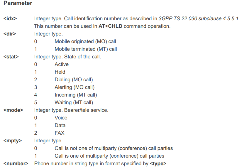

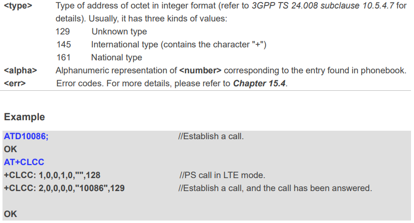

If you are using a device with Quectel modem, the command to check call status is this:
gsmctl -A 'AT+CLCC'
And the response contains the following information:
