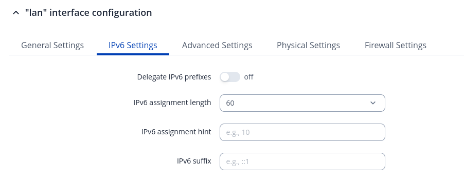

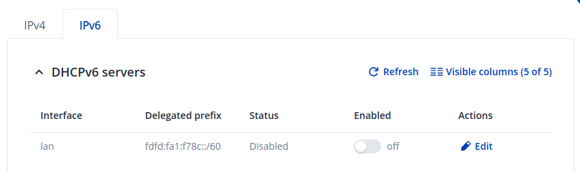

Hi, via WebUI it can be done like so:
You can disable router announcements by disabling whole DHCPv6 server on LAN interface
If you want router to loose ULA address then set IPv6 assignment length to Disabled on LAN interface and restart router
Like this?
It is off.
Like this?
So I need to explicity set the assignment to “Disabled” even if “Delegate IPv6 prefixes” is already off?
Greetings, Marc Haber
  1. Yes, did it helped with unwanted RAs or it was turned off originally?
  2. In my experience this effects only PD coming from dhcpv6 clients but not ULA

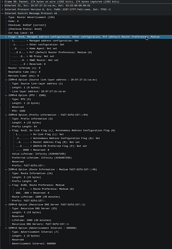

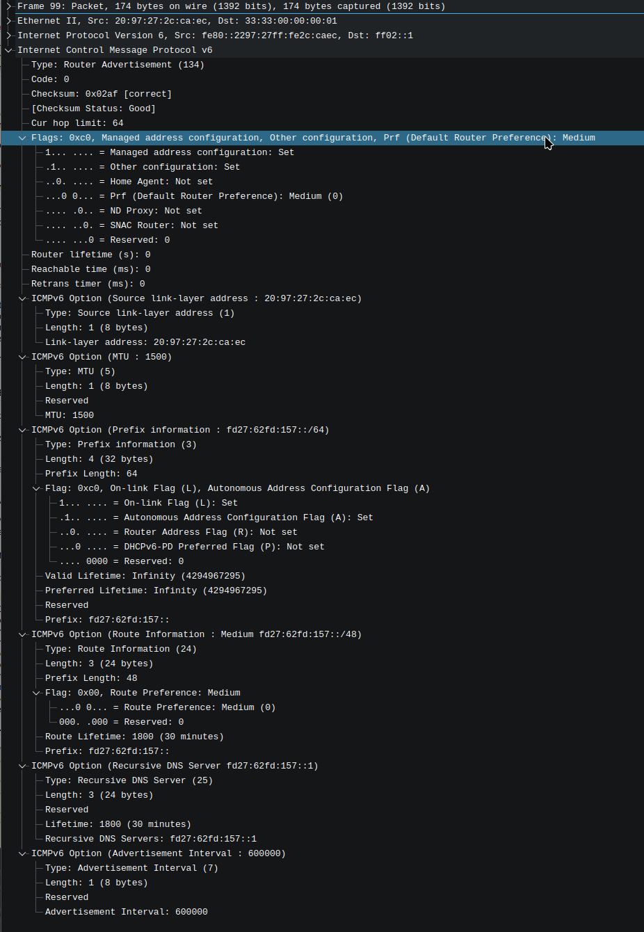

To make things worse, your devices announce that prefix with unlimited lifetime (preferred lifetime: “infinity”) so that it needs manual intervention on every node that has processed the router advertisement to get rid of the unwanted IPv6 configuration. I can send you a pcap from the LAN interface to describe. Wireshark screenshot attached.

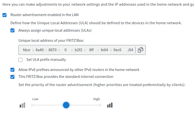

Other Router vendors offer like this:
(and this is hidden behind an “advanced” switch and off by default)
