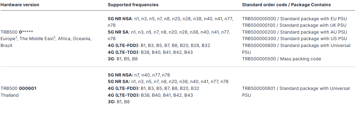

In regards to the mobile modem, all you should consider, with which mobile bands, does you Sim provider work. In the device details on our website, in ordering section you can find with which mobile bands, what product code device works. TRB500 5G Gateway
If you are only considering a gateway, then yes, TRB500 or TRB501 are your only options from our portfolio.
