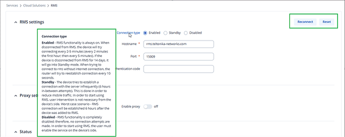

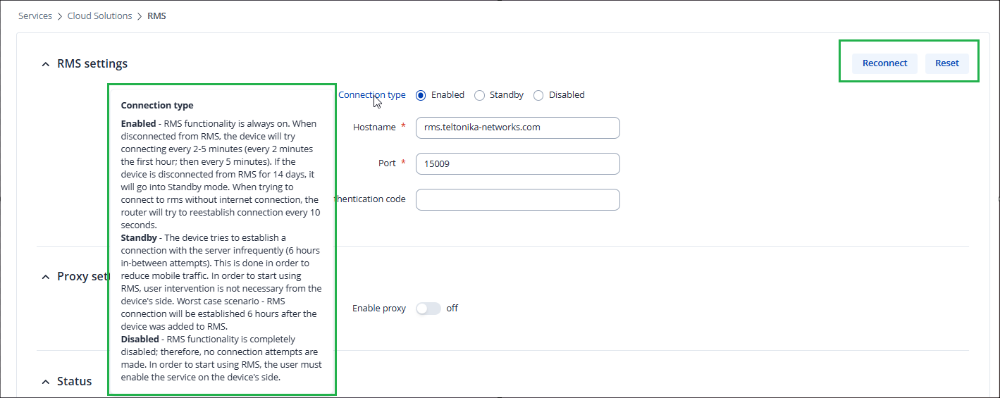

If you just recently activated from newly purchased RMS credit, now you just need to wait up to 6 hours.
In essence, the device does NOT try to connect to the RMS often, but instead does it once every 6 hours to preserve mobile data. During the next connection attempt, it should be able to connect to the RMS.
If you have physical access to the router, navigate to the “Services → Cloud Solutions → RMS” menu, and click the “Connect” button at the top right corner of the page. If you would mouse over the “Connection type” text, you will see more information about the 6-hour connection frequency:
