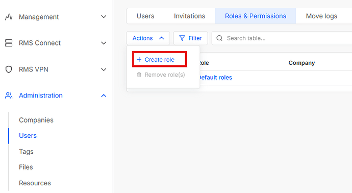

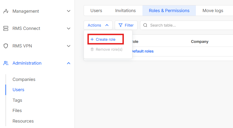

Good afternoon,
If you go to RMS Administrations → Users, roles and permissions, you can create a new role, under which you can assign the newly added member.
That member will have the rights in RMS, as chosen in your setup.
I do want to note, that in that screen you can choose which functions the user will have access to, but you cannot specify, that that user will be able to connect to only one specific VPN Hub, or one specific RMS quick connect instance. The user will have access to all VPN Hub or RMS quick connect instances.
Arturas
