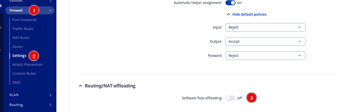

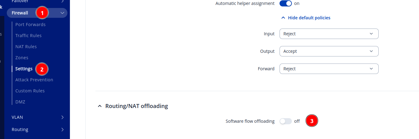

I just wanted to update and let anyone facing a similar issue know that after disabling the “Software flow offloading” option (found under Network → Firewall → Settings) on both routers and performing further RDP/NAS connection tests, the issue seems to be resolved.
SW flow offloading option
