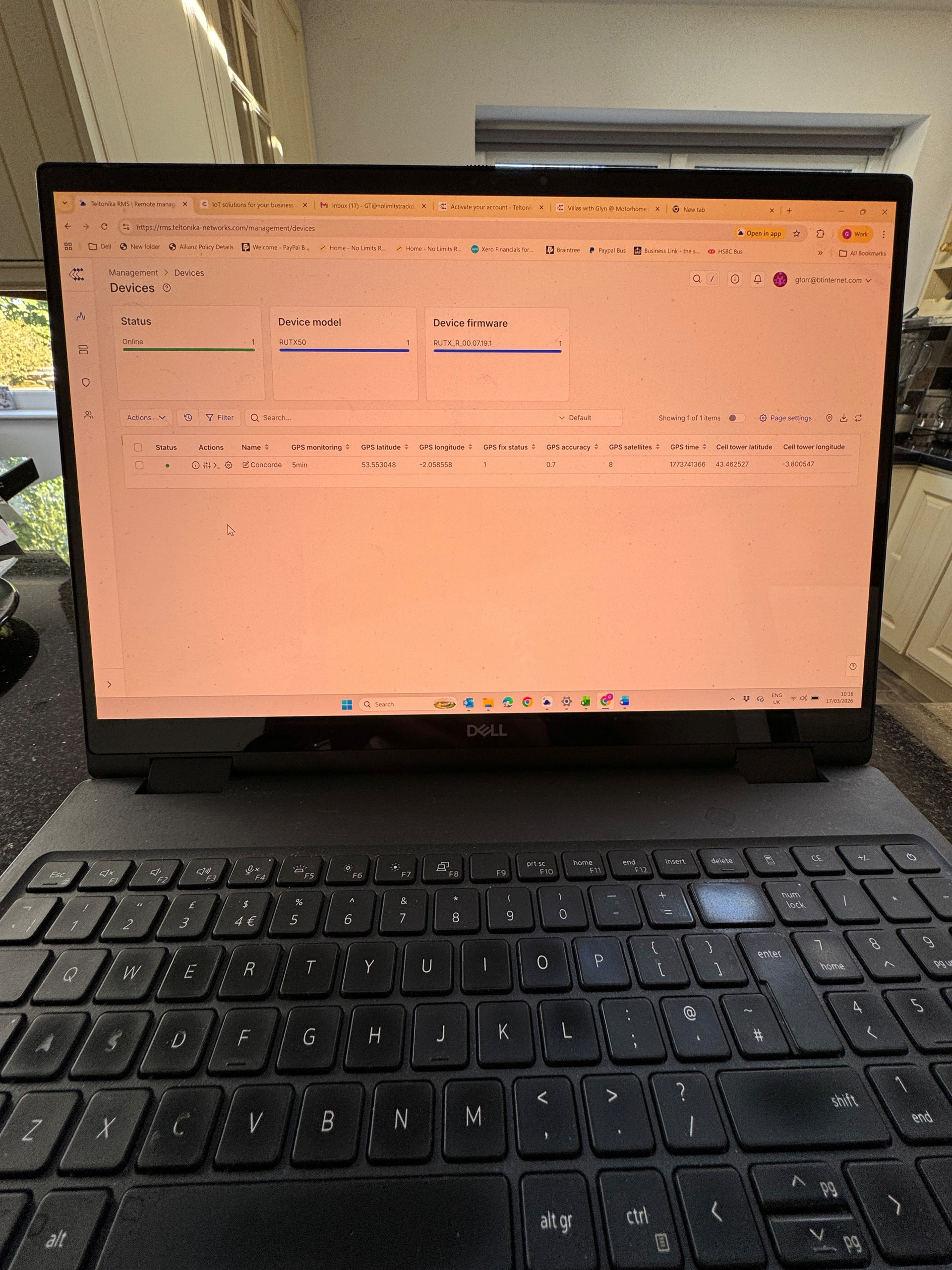

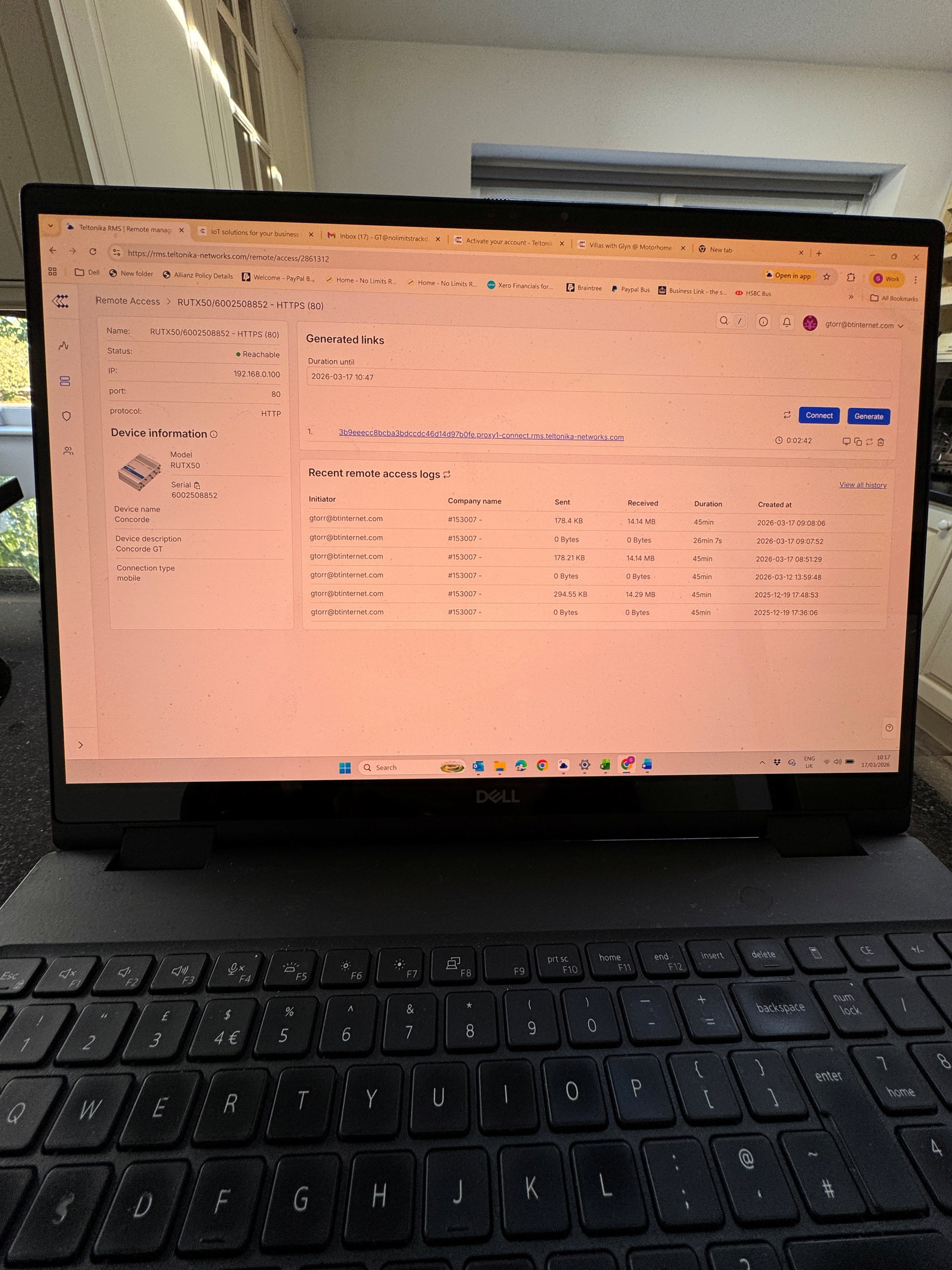

So I have installed a Maxview Roam Reuter, I will send you a screen shot
I am trying to remote access my motorhome form either my : Laptop, Phone or Ipad
I have an EE sim card in the router and I have also purchased a 10 year licence from Teleonica

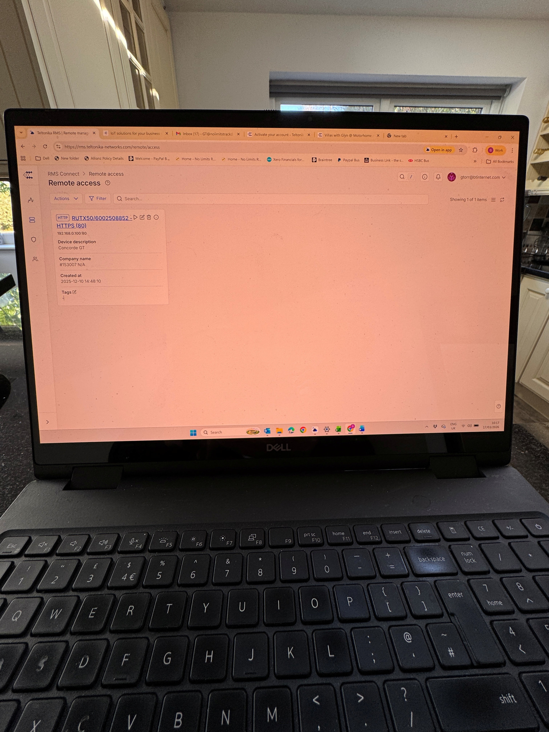

I now have “reachable in the menue” - see screen shot

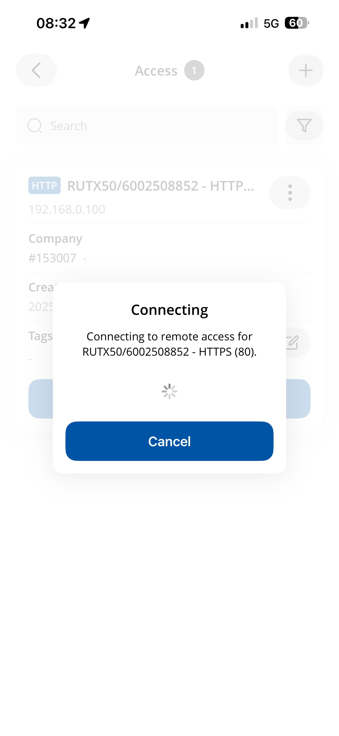

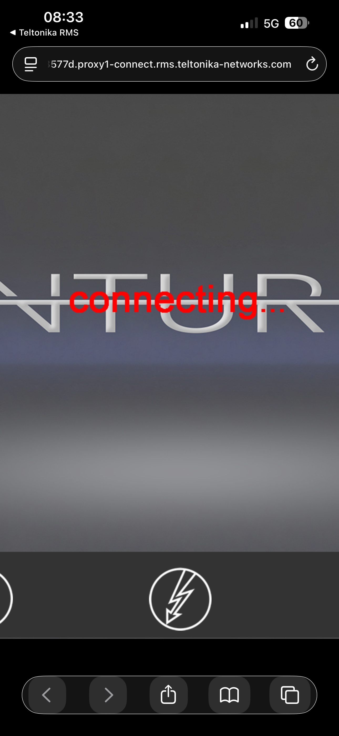

I have gone to remote access and it says connecting but does not complete - See screen shot
Can you please respond as soon as possible thanks Villas

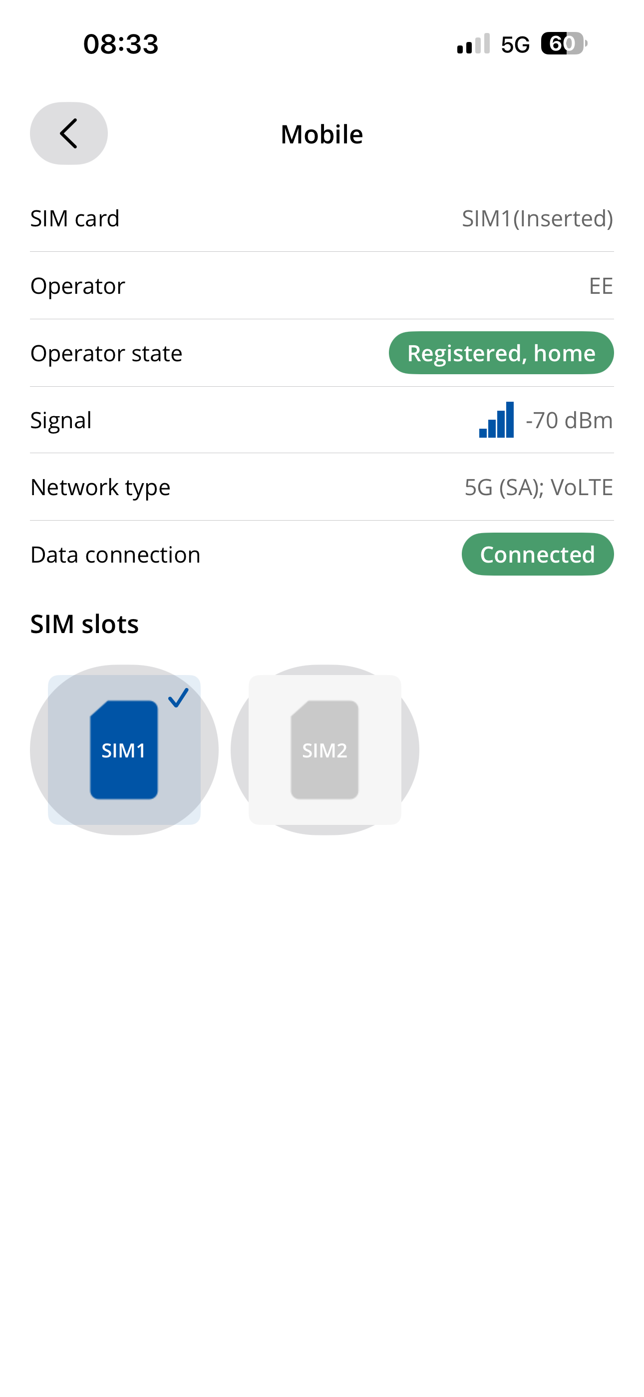

  4. Somewhere something has gone wrong, I’m not sure if he SIM card has been put into the other slot there is 2 x slots in the router ( 1 and 2)
  5. Screen shot of router saying connecting but does not connect
  6. I think settings internally talking is the issue ?

I am pretty sure the RMS credit or wether the Roam Maxview Router has a RMS connection is not relevant. I’ll try to break it down:

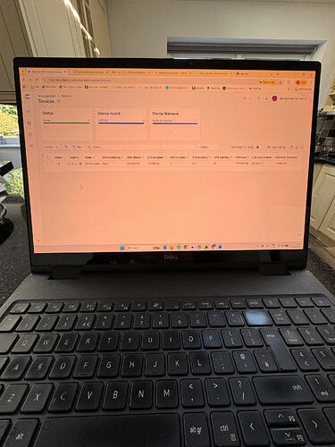

  • The Roam Maxview Router does have an internet connection through it’s SIM card, otherwise your RMS portal (your first screenshot) would not show it online.
  • but the question is if the Centurion system in the RV has a connection to the wifi access point (or a LAN port via a network cable) in the Roam Maxview router, and wether the Centurion system can reach the internet through it.
  • i can’t find information on the internet how remote access to the Centurion system works technically, but if you were able previously to get the Centurion screen on your laptop or phone while not connected to the wifi access point in the RV, then remote access was working. If thats the case, it’s a matter of getting the Centurion system in the RV connected again to the Roam Maxview Router, for that you wil l have to be present in the RV. My guess is you can log in to the Centurion system through a wifi access point the Centurion system presents you, in which hopefully you can enter the wifi details of the Maxview router.

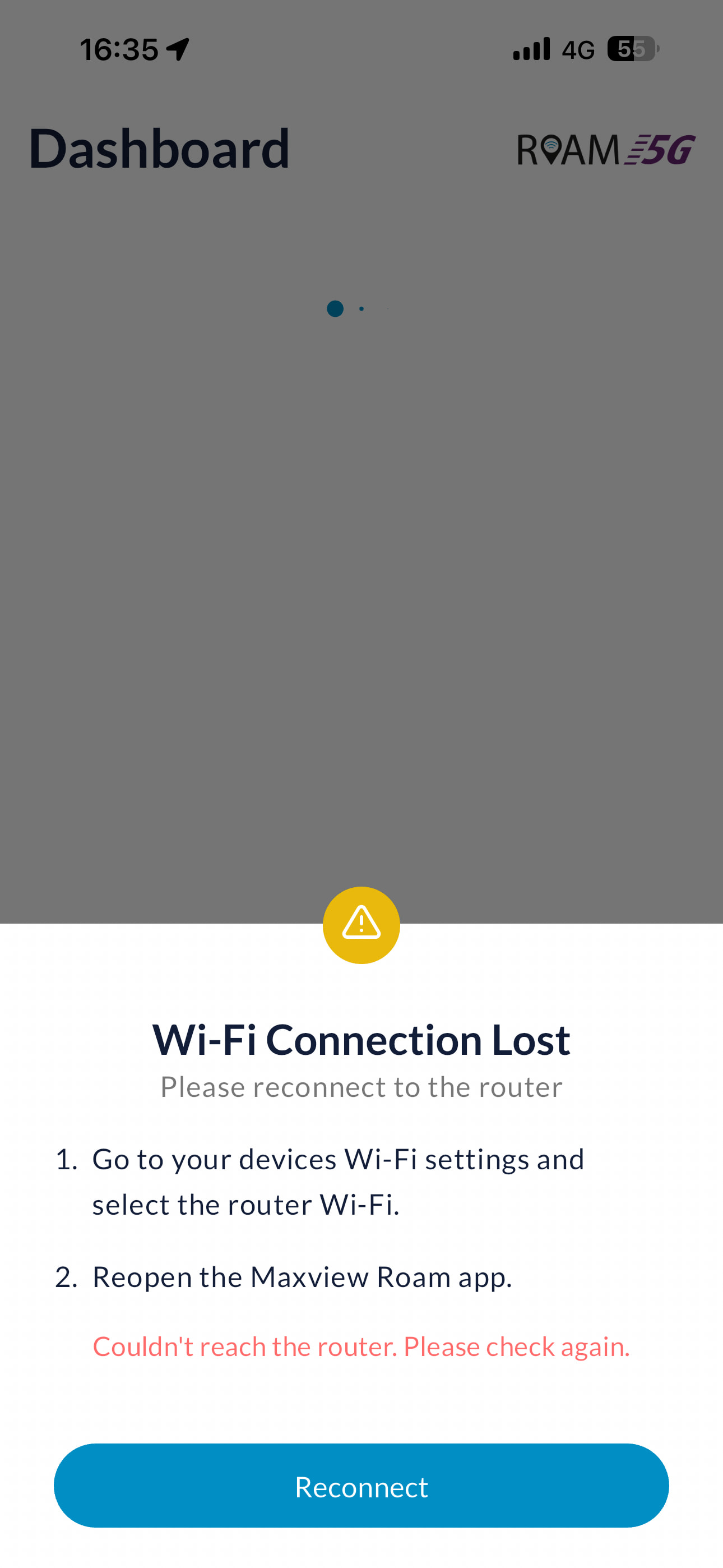

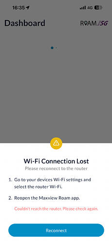

To add: the picture showing W-ifi connection lost is a picture trying to open the Maxview Roam App while your phone is not connected to the Roamview wifi network, that app will only work when you are in the RV connected to the wifi network the Roamview provides.

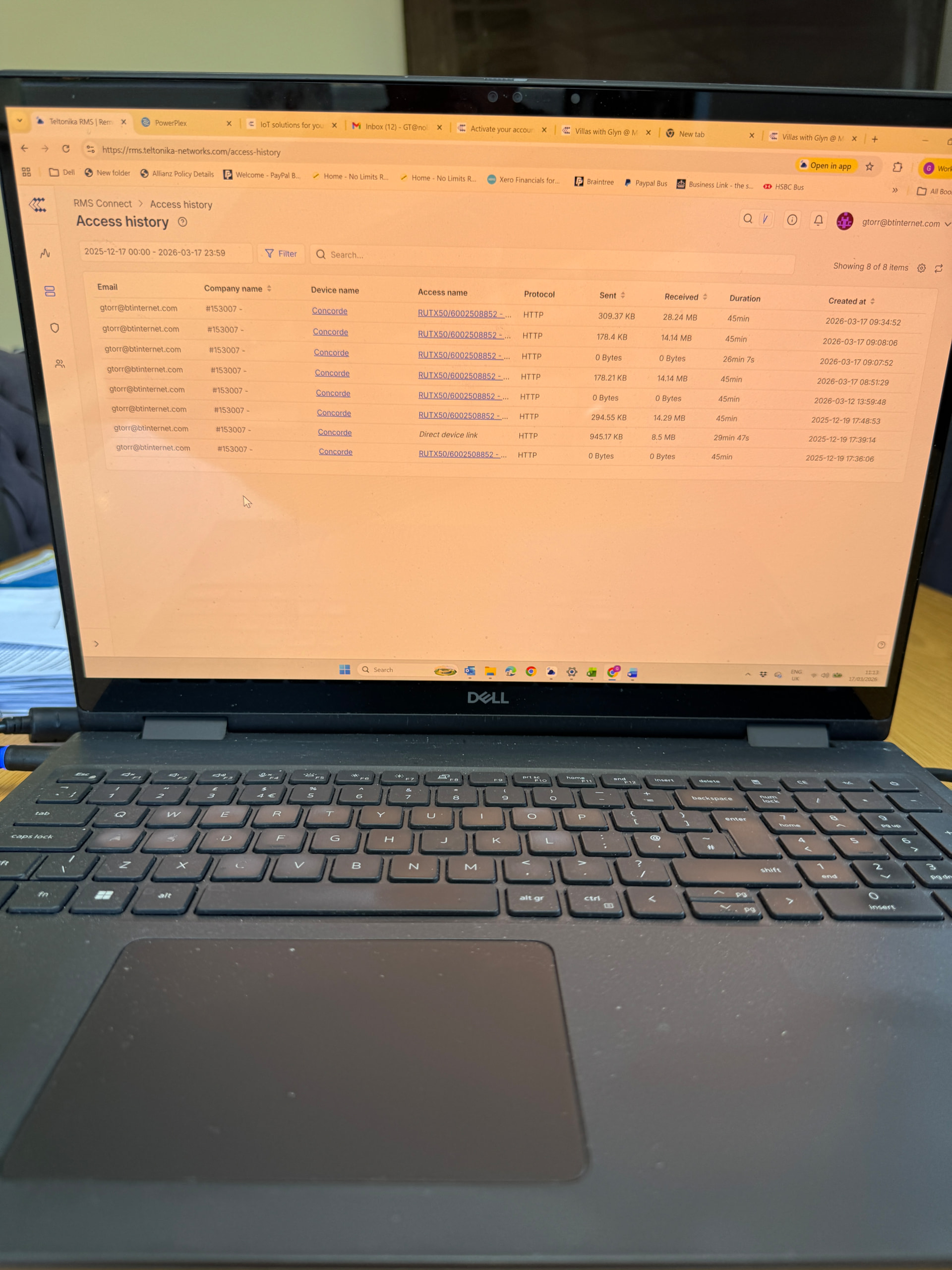

So just took some screenshots whilst sat in motorhome
A, this helps.
  • strike my remark about RMS not needed, your screenshots show you (try to) gain remote access through RMS so its needed.

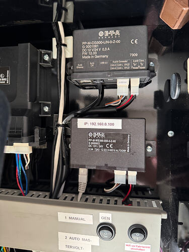

  • the black box marked 192.168.0.100 is the ‘gateway’ to your Centurion system , its connected through the Maxroam router via a network cable (the bottom left ribbed plug).

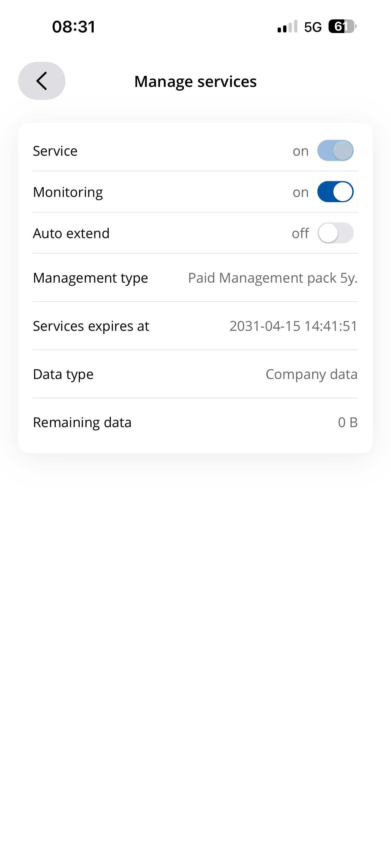

  • i’m not sure if i should take the Remaining Data: 0B seriously, if so the simple fact is you have run out of data, or there is a data limit set in the Maxview router which is reached. Could either be the case?
Addition: that bottom left ribbed plug on the box marked 192.168.0.100 seems a bit low, maybe it has dropped out. Can you push it up? If you hear ‘click’ we have found the cause :slight_smile:

  3. Question - Do I need data on the RMS to use remote or does it use the EE sim to connect remotely to me when i am not near the motorhome
  4. also when my phone is connected to the motorhome wifi i still cannot access the remote sysyem it just say connecting

Hi PW here: you need a data balance on your EE sim card to let the Maxview Roam connect to the mobile network and RMS in order for you to view the Centurion system on your phone or laptop (wether you are in the RV or not). You could switch the EE sim card temporarely for another one (ie from your phone) to check if that solves it.
But if the RMS portal still says the device is connected like in your first picture i would assume you still have data left, otherwise it wouldn’t be connected.

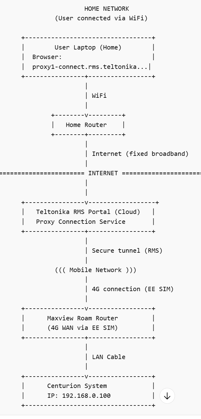

For your understanding here is a diagram how its all connected. What Villus can do is check wether your Maxview Roam is reachable from the internet and if data traffic from the Centurion system makes it through the Maxview Roam router to the internet and back.

I am very surprised a problem with the sim in the Maxview Roam Router is suggested as the cause, because you can reach the Teltonika RMS site and it says that the device 192.168.0.100 is reachable. So there is a mobile connection to the internet from the Maxview Roam Router, that means the sim is working.

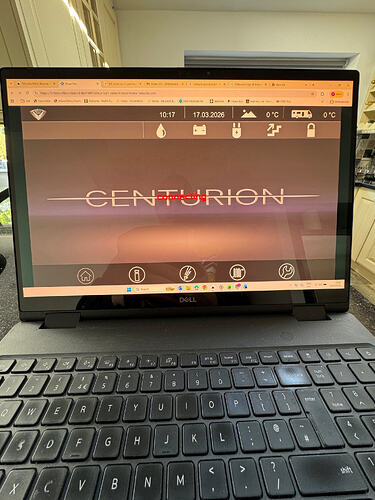

If you are in the RV, and you are connected to the Maxview Roam Router wifi network, does typing 192.168.0.100 in the internet browser lead you to the Centurion system?. By checking this so-called local access we can at least determine wether the Centurion system is still working correctly.
If https://192.168.0.100 while in the RV does bring up the Centurion system, the culprint is in the Maxview Roam Router configuration.
