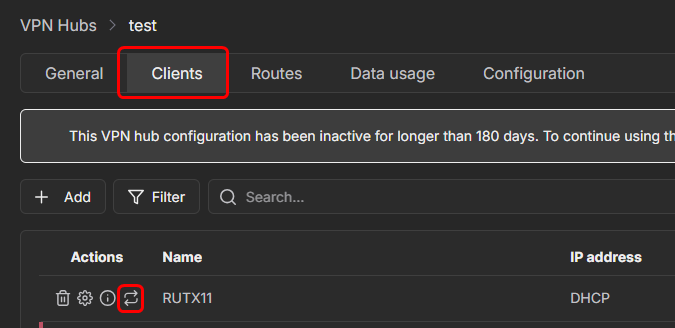

  3. Head to the clients tab in the VPN Hub, and hit the “Update configuration and certificates” button:
Finally, re-test the pinging, if it still doesn’t work - please confirm that the PLC is reachable from the device itself, in other words, make sure you’re able to ping the PLC from the RUT200.
