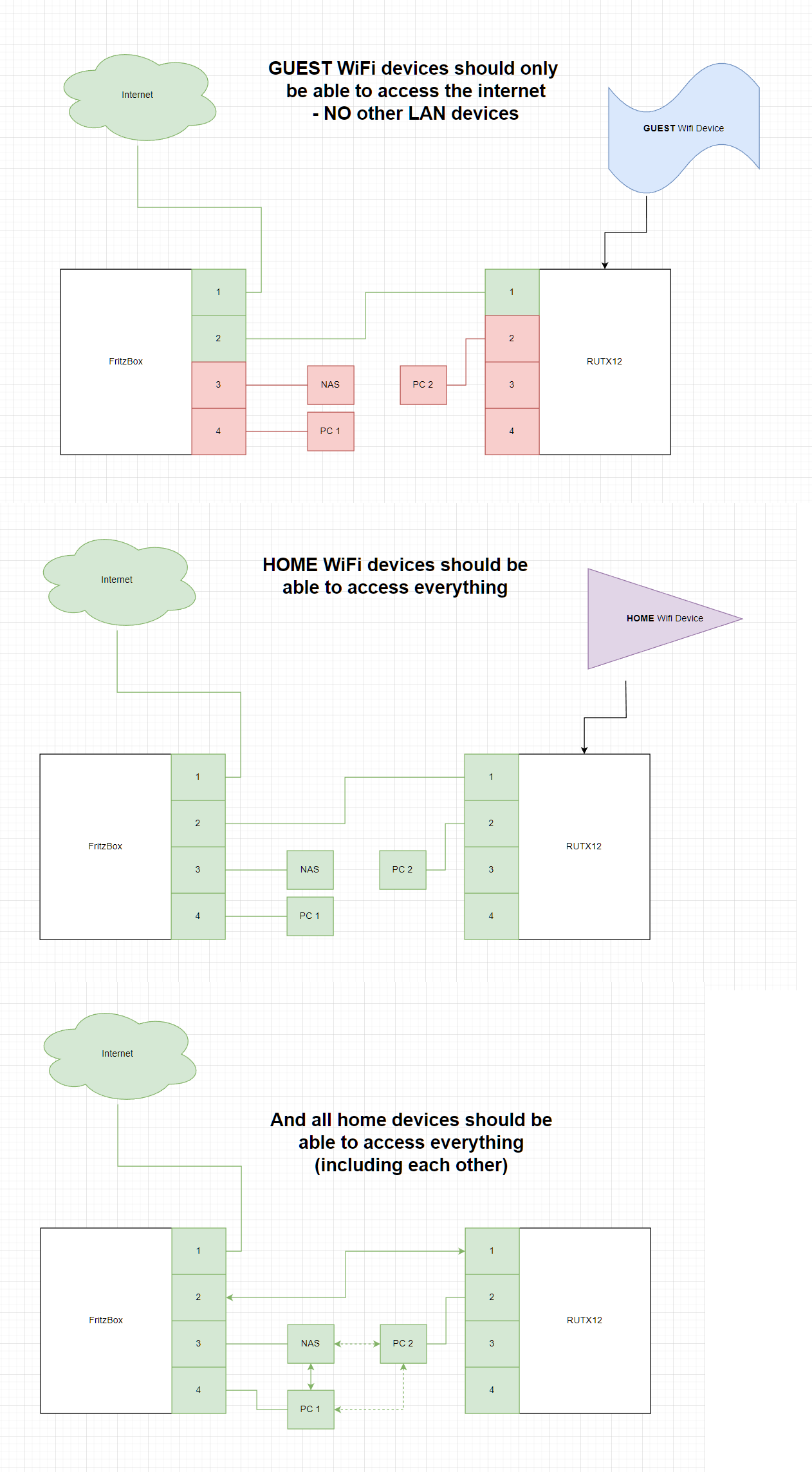

This works fine and I can access the internet and these other LAN devices via the RUTX12. However, what I can’t figure out is how to set up firewall rules so that I can restrict certain devices to internet access only (no inter-LAN communication).
Basically I want to create a “Guest WiFi” where WiFi clients can access the internet but not any other devices in the home network.
Teltonika has a guide on how to do this, but it uses the “WAN” interface in a firewall rule whereas obviously my FritzBox is connected via LAN.
Is there a way I can configure the RUTX12 to treat the FritzBox’s internet connection as the WAN, so I can restrict Guest Wifi clients to WAN only, but still let my home devices access the FritzBox’s LAN ports?
Here is what I want to achieve in diagram form:
Yes, as mentioned in the wiki guide regarding Guest Wifi, WAN interface is rule is needed. Though I can’t test it today (probably tommorow). The way I will approach your requirement is connect the RUTX12 WAN port to the LAN Port of your FritzBox. From there, I will utilize the Hotspot functionality of the RUTX12 to seperate the Guest Wifi to the LAN network of each routers.
To allow connectivity between Home WiFi device to other LAN devices, either I would use static routes, to the LAN IP of the Fritzbox or Relayd.
