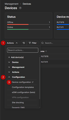

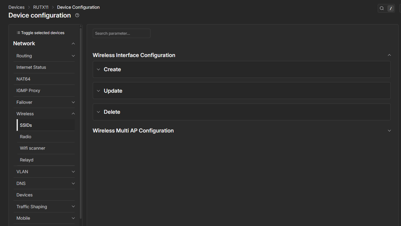

To set up configuration templates in RMS, you’ll first need to select any online device, then open Actions → Configuration → Device Configuration.

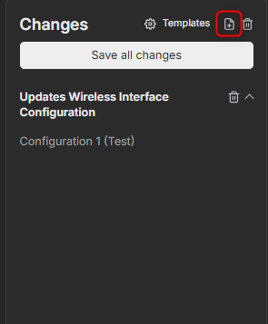

From there, navigate to Wireless → SSIDs → Wireless Interface Configuration and adjust your WiFi settings as needed. Once your changes are ready, use the save button to store the configuration as a template. This saved template can later be assigned to any device through tags.
To save configuration template press this button:

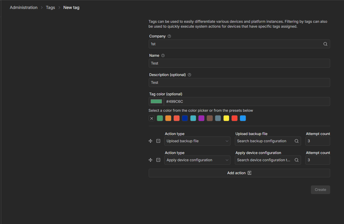

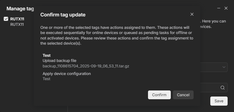

After the template is created, you can manage deployment through Administration → Tags. Create a new tag, add the desired actions (such as applying a configuration template or uploading a backup), and assign the tag to your devices.
Tag creation window:

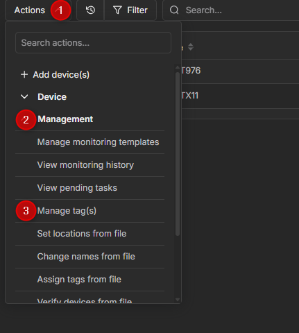

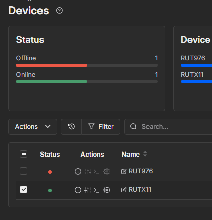

To add a tag, select your devices, click on Actions->Management->Manage tag(s)
If a device is currently offline, RMS will queue the actions and execute them automatically once it reconnects.
