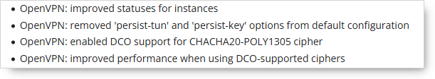

However, these were the OpenVPN-related changes in v07.13 and I guess they will remain in a corrected version:
