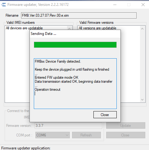

Still not working, tried using the file that was in the firmware updater folder, but it didn’t work so I tried to use the one that you sent, but it still didn’t work.
It went to like 20% and then said operation timeout.
Please try to format the flash memory of your device after that try to update the firmware again.
If it didnt work it seems the device is already faulty or you need to update with the older firmware than 03.27.07.00, FMB001 is already EOL device.

Formatting worked, thank you so much!
