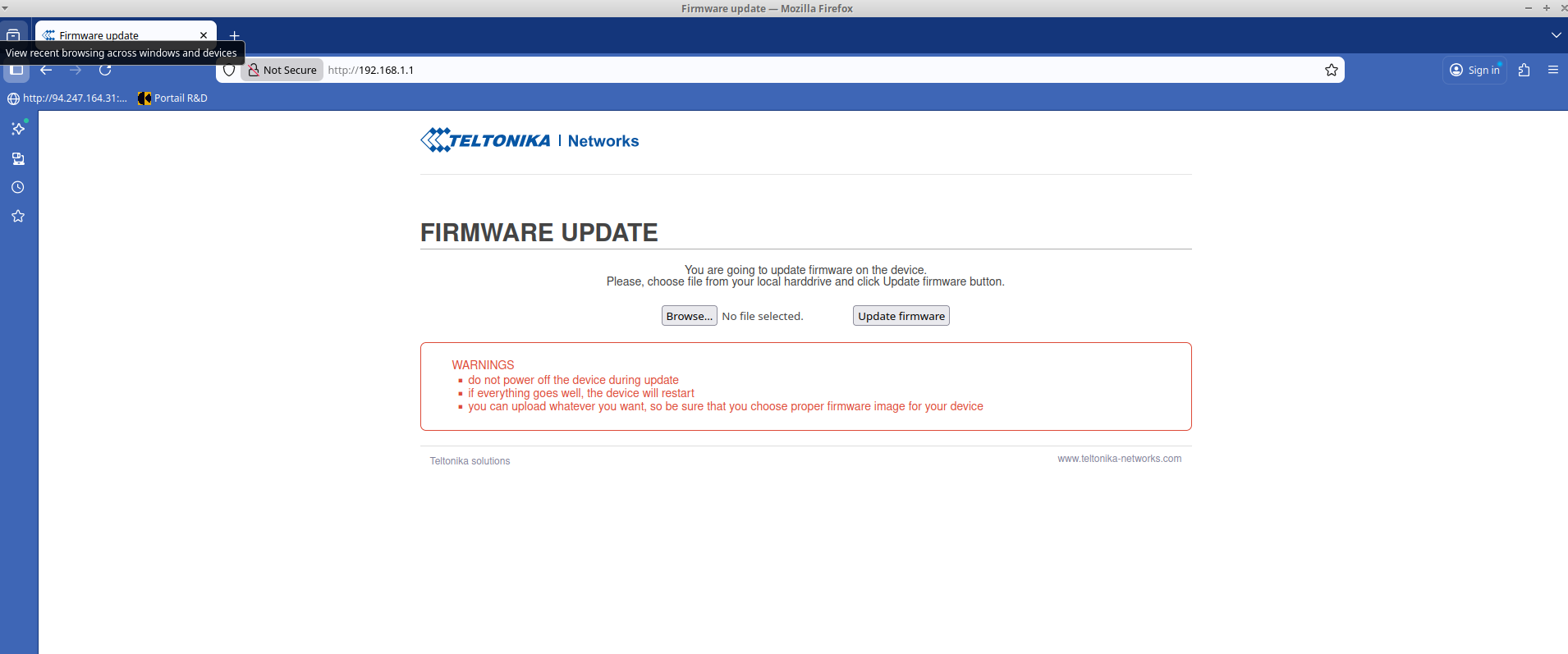

I want to ssh to RUT955 but it fails.
When I connect through a web browser, it display directly the following firmware update window:
As soon as I upgrade the firmware, I can ssh to the devices.
Does anyone know how and why the RUT955 get this state?
Can I fix this state by some way, without updating firmware?
Please note that I have a script which try to update the firmware if needed. When the RUT955 is in this state, it doesn’t work (because no ssh connection) but maybe the devices get this state because a previous firmware update failed?

If you get to this page each and every single time you reboot the router, it looks like your device is stuck in the Bootloader state. More information can be found here: Bootloader menu - Teltonika Networks Wiki
If what I said applies to you, then we consider this to be a hardware-related issue that can only be resolved by either replacing or repairing the device; This process is usually done either by us, or by the reseller/distributor that you’ve purchased the device from, though your device looks to be old, so warranty is most likely due.
