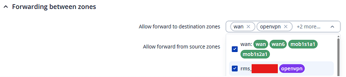

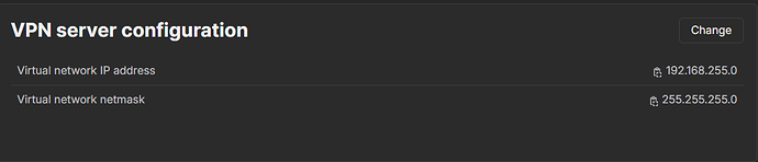

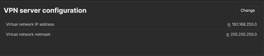

The issue was resolved by changing the virtual network IP address so that it no longer overlapped with the RUT241 LAN network.
Next, a static route for the entire subnet was added using the 255.255.255.0 netmask.

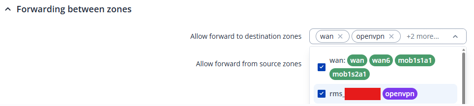

Finally, under Network → Firewall → Zones, in the LAN zone settings, the Forwarding between zones section was updated. The Allow forwarding to destination zones field must include rms. This ensures that traffic from the LAN can reach the RMS VPN.
