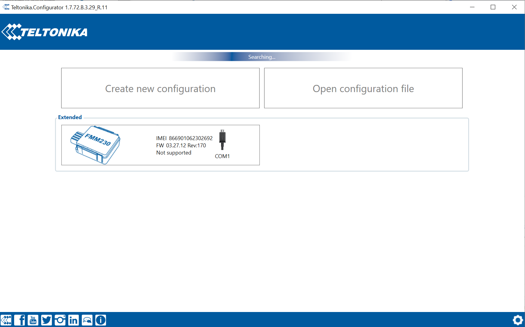

Unable to config FMM230 in the configurator due to message “Not supported”
I’m trying to connect an FMM230 but the program tells me it’s “not supported” ( FW 03.27.12 Rev:170 )

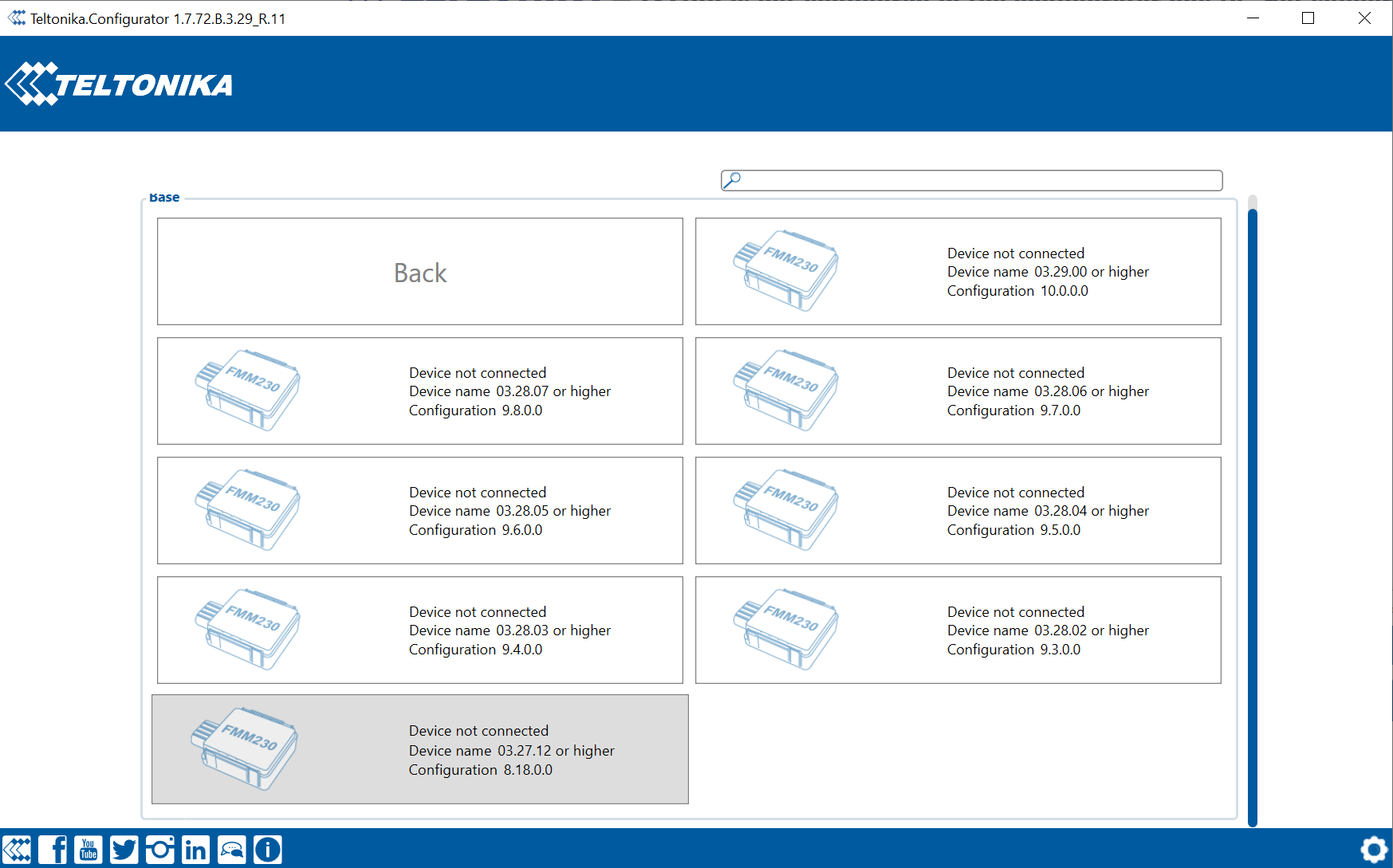

But I can create a configuration file with this program:

Hello @Spokesman8729
The error is due to mismatch between the device firmware and the configurator version you are currently using.
The configurator for the device is not from the same or a supported firmware version.
You can create HD ticket via https://teltonika-gps.com/ and click on the “Contact Us” button. When you click, please fill out the form and submit it.
This way, we can share with you the configurator for this version.
