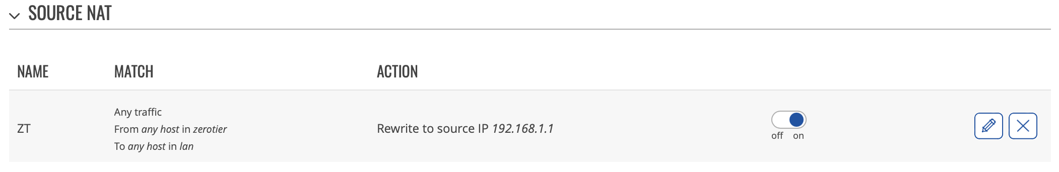

I got it working by adding the following NAT rule
