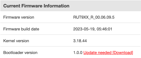

Yes, it was downloaded to the device via 192.168.1.1/index.html and yes it was the latest legacy version. The update was sucessful from version 00.01.Something
If the update was successful, there should be no need to update the bootloader version, even if you see a notification about it in the WebUI.

So there is no way for me to get the bootloader file to upgrade it?
Unfortunately, there is no need to update the bootloader if it is functioning as expected.
