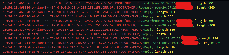

With a both the dhcp interface and a static interface enabled, tcpdump on the RUTX11 shows DHCP activity (not sure why 3 in a row, but that’s what it did):
Repeating the test with the static interface disabled results in no DHCP activity shown by tcpdump.
