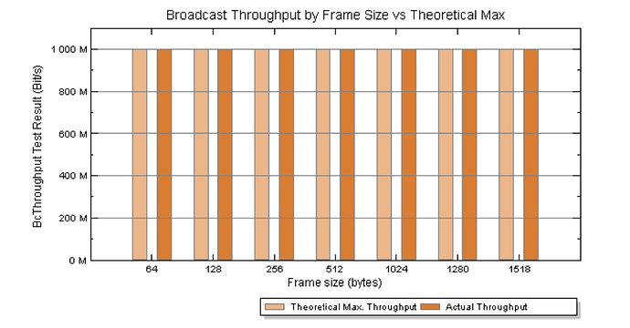

Our testing team also confirmed that when sending large bursts of packets using various packet sizes (64, 128, 256, 512, 1024, 1280, and 1518 bytes), both devices experienced 0% packet loss across different test durations.

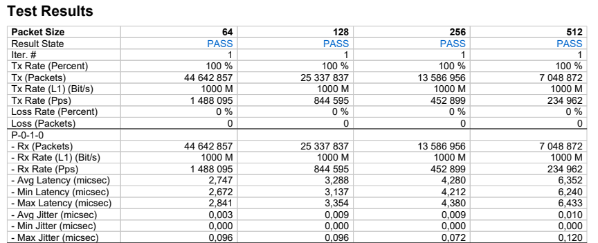

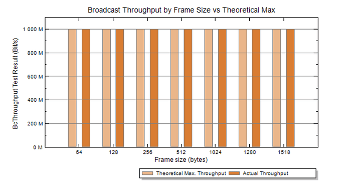

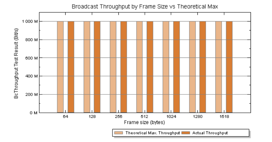

Below, you can find the graphs from the testing results:
TSW101:
TSW200:

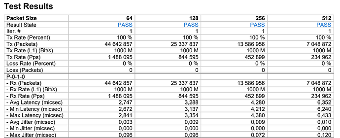

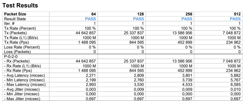

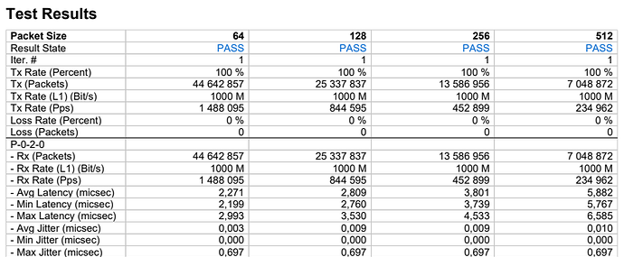

Additionally here are a few screenshots with some test results from both devices:
TSW101:
TSW200
