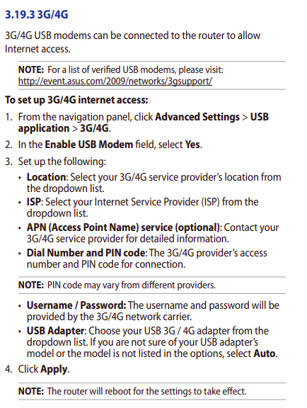

I have Asus GT-BE98 router and would like to setup a backup 5G internet connection to my fiber connection. Can I use the TRM500 for that purpuse? Anyone having any experience in this?

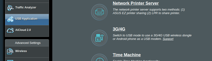

Some Asus routers have ability to connect USB modem:
Checking manual seems your Asus GT-BE98 supports USB modems, but as I understand you either use fiber or 4G/5G connection.

It took some time but I managed to get some respond from Asus. Asus seems to have the same list of verified USB modems as they had when I had another ASUS router 5-10 years ago. Most an these modems are not possible to buy anymore and support only up to 4G, which means that they are not interesting for me, I want something that is more future proof.
What I really wanted to know from Asus was the technical requirements for a modem that can be connected to USB port (used for fail over connection) on my Asus router, but I haven’t managed to get that information.
